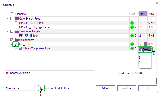

Until the cause is investigated, can you try rolling back to revision 1?
To rollback you can follow the instructions here.
Roolback Component.png (27.54 KiB) Viewed 10850 times

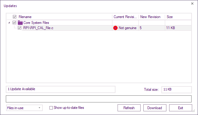

And when I try to update the components I get a 'not genuine' version shown for, I think, the same component:
I am unable to download and update this component.
Re: RPi File Component
Posted: Wed Sep 27, 2023 10:36 pm
by BenR
Many apologies, should be resolved for you now.
