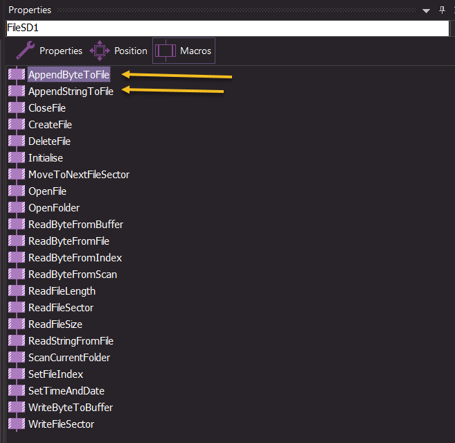

Hi WingNut
a simple way is with append

Thanks Stefan. I want to add data to specifically the first bytes of the file. Sort of the write equivalent of ReadStringFromFile
