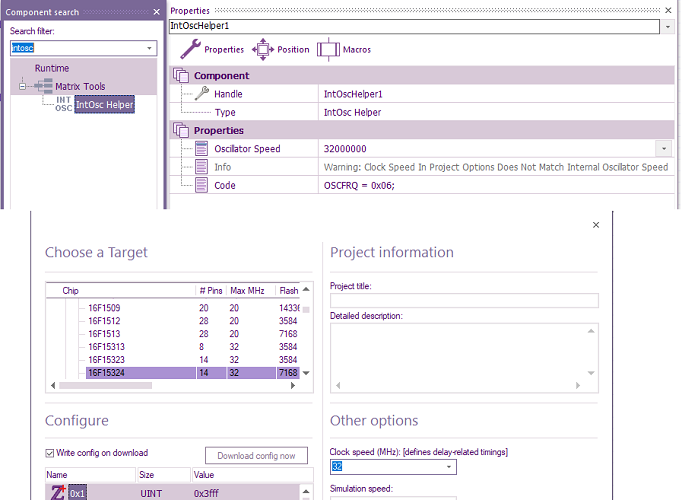

When using the PIC16F15324 the FC target options for HF internal oscillator are 1MHz and 32MHz.
Under 'other options' is the clock speed setting which defines FC timings. This only allows a max value of 20.
Could this be changed to allow for the 32MHz timings.

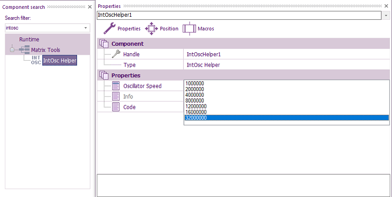

What you may or may not know is the IntOsc component can be used to generate the required C code to set the internal osc frequency.
The options are:
Int Osc Options.png (69.72 KiB) Viewed 1885 times
After selecting the options, it displays the C code to enter within a C code block:
16F15324 OSC.png (105.88 KiB) Viewed 1885 times
Also, note that you need to manually enter 32 within clock speed rather than using the dropdown.
