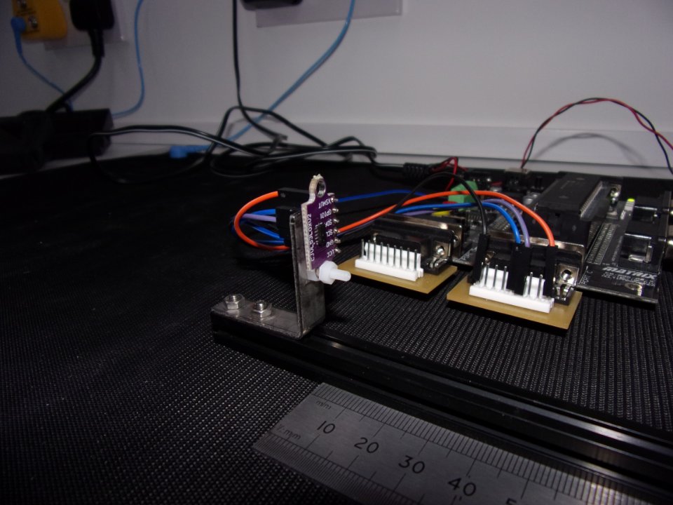

In the post I mentioned that the accuracy was a bit "suspect" which may have been due to it being a cheap module available from a well known marketplace. I decided to obtain a better module that used genuine components and compare the two.

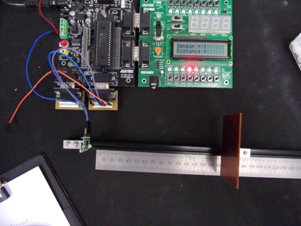

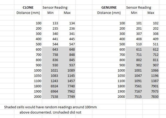

My set up was that the module would be fixed to a length of "Makerbeam" and a target would slide along the beam. A steel rule would be used to measure distance between. The same code which averaged 100 readings was used to interrogate both modules in turn. All measurements are in mm with the delta in brackets.
The above surprised me. At 50mm and above (with the exception of 150mm) the cheapo module appears to have a reasonably consistent error of 15mm which could possibly be factored in. However the cheapo did fluctuate if left alone whereas the genuine was consistent. If I moved the target 1mm then the genuine reading would change accordingly, the cheapo sometimes didn't register.

I was pushed for time as I was setting up for something else and took the opportunity to do a very basic test. I was considering using one of these to establish if there were any obstacles in my way over a given distance, and as they are compact and accurate enough for me to establish if anything is in my path I'll probably experiment a bit more.
My code was simplistic in the extreme. Test to see if the sensor is connected then Loop one hundred times whilst averaging the readings. I didn't even use any of your great averaging techniques that help smooth out randoms. Maybe with more diligence, results could be tightened.
I initially used a relatively small target and with that results were appalling. That piece of PCB in the picture made a huge difference to the accuracy. Discrepancies in delta of a mm or so between distances could easily have been down to me. At the weekend I'll probably set it up on a two metre rail facing a wall and do some further testing.

Did the experiment out to two metres. Despite documentation suggesting it could reach that far neither were of any use above ~1100mm and that is stretching it. Clearly they like big targets so detection of a human or such like is well within capability.
Above 600mm I would get random readings of approximately 100mm above what was the normal. Beneath 600 this didn't occur.
Size of target is clearly making a difference. With a wall to bounce off of the genuine chip beats the clone hands down which wasn't the case with the smaller target (although that could have been due to slight misalignment).
Code as before, the most basic grab and average you could come up with.

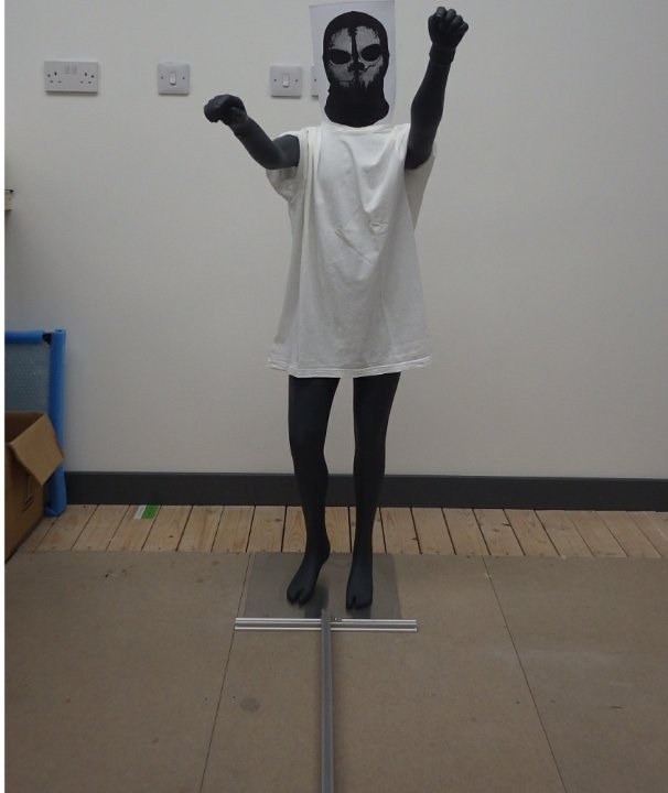

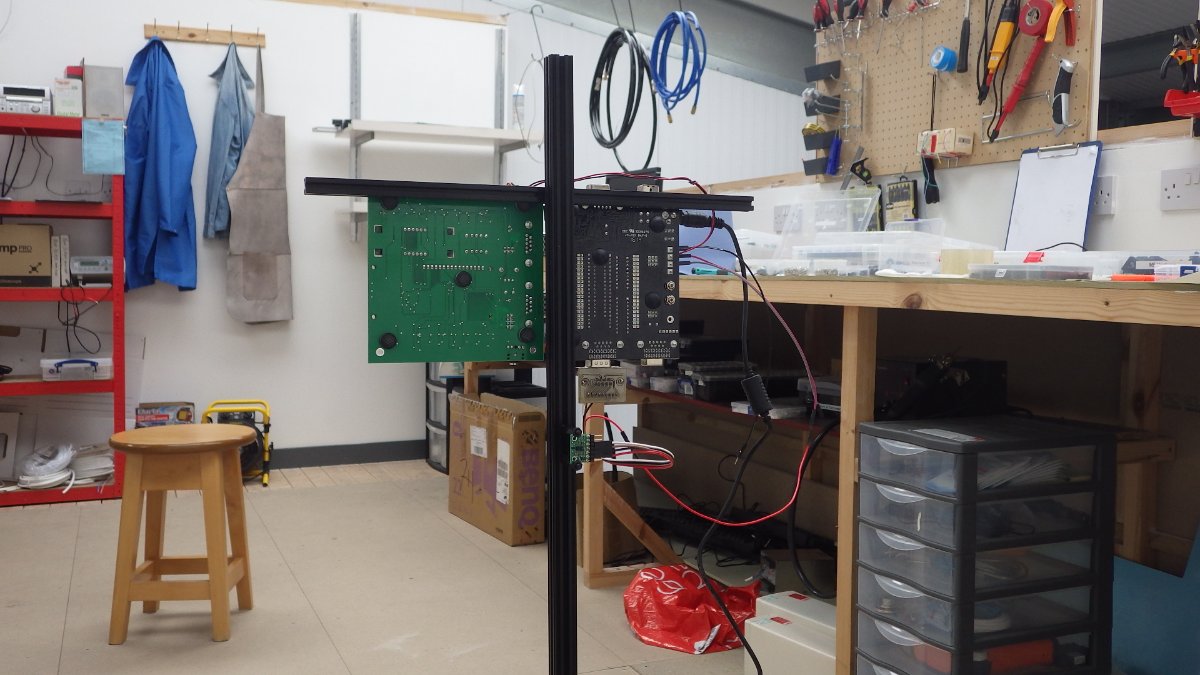

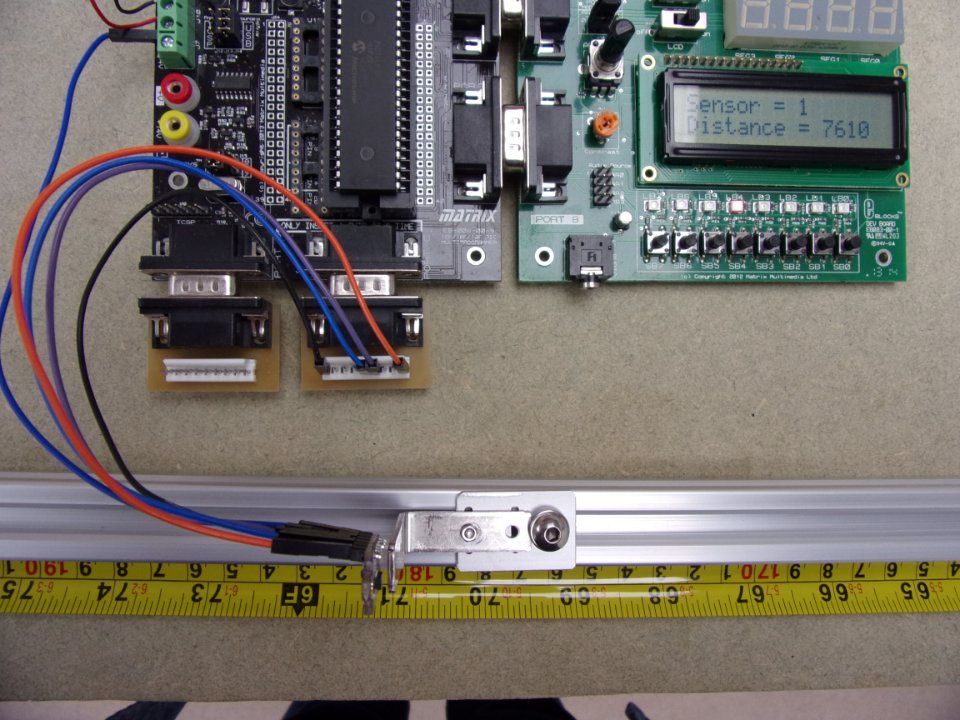

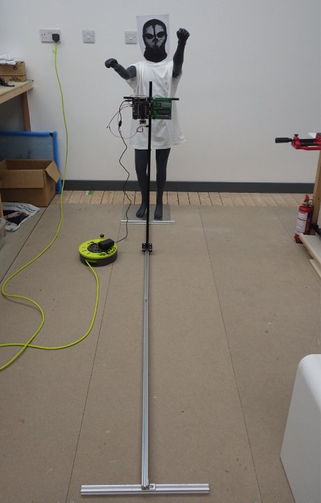

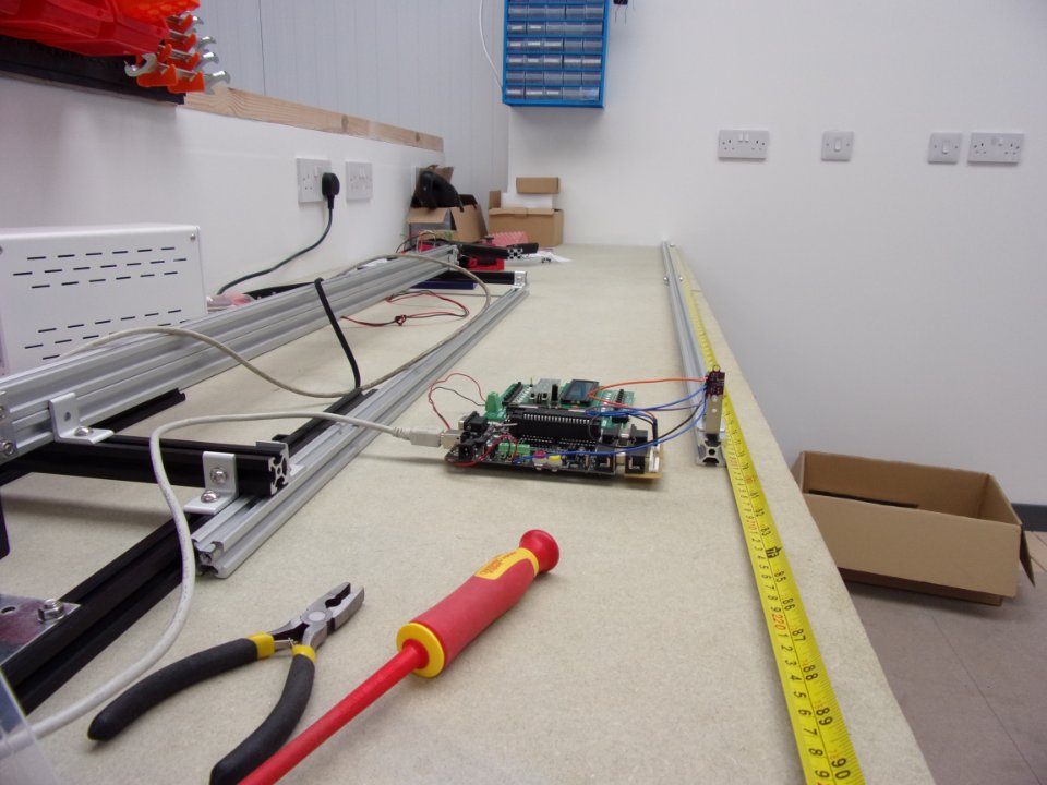

As per attached pictures, I connected a sensor to a combo-board and mounted this on a two metre rail to move freely away from a relatively tame zombie.
As per previous tests, I used the most simple of loops to average 100 measurements and display the reading. I then documented five consecutive readings. The distance from sensor to zombie was measured using a tape measure so the actual distance was no more than a few millimetres out.

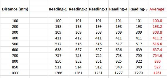

Up to 200mm we can see that it's quite accurate as the discrepancy could easily be down to me. At 300 and 400mm there was no way I was ~10mm out but the readings were consistent and within 3% of actual. I would say the same for 500mm as I could easily be a few mm out in my measurements.
At 600 and 700 the readings, although quite consistent, are quite a bit out. At 800 the readings started to be less stable and by the time we reach 1000mm there isn't any real accuracy. At this range random readings started to appear up to 1411mm.
Not much above 1000mm it became too unstable and gave wildly inaccurate results between 3000 and 7000mm (incidentally when simulating the maximum distance reached is 1200mm).
Despite documentation stating that the reflectance of the target doesn't factor I have to disagree as without the t-shirt I could not get stable readings much further than 300mm and would frequently receive readings in the thousands.
So, based on my tests it would be ill advised to rely on one of these modules to alert you in time to prevent certain death...

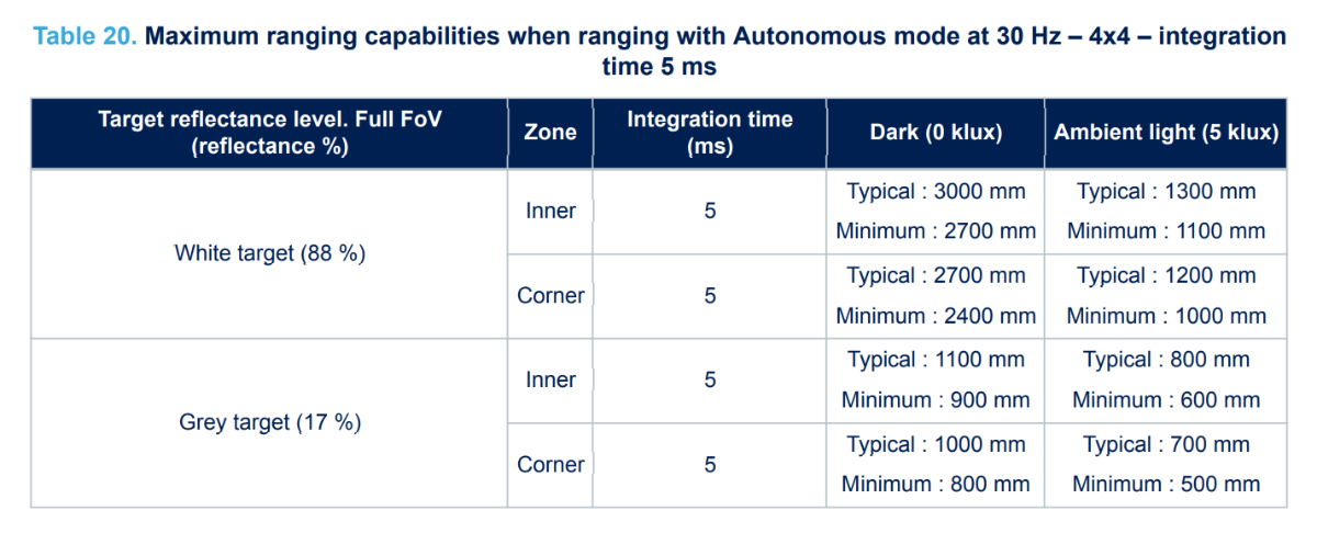

Just reading the datasheet - and it looks as though the accuracy you are getting is pretty good.
Certainly - accuracy in the dark is much better than in the light - so might just be the limits of the device..
This from datasheet (for the '1' variant - which I think has a longer range
Not a problem - I think zombies usually move at night. They are certainly harder to spot then?
