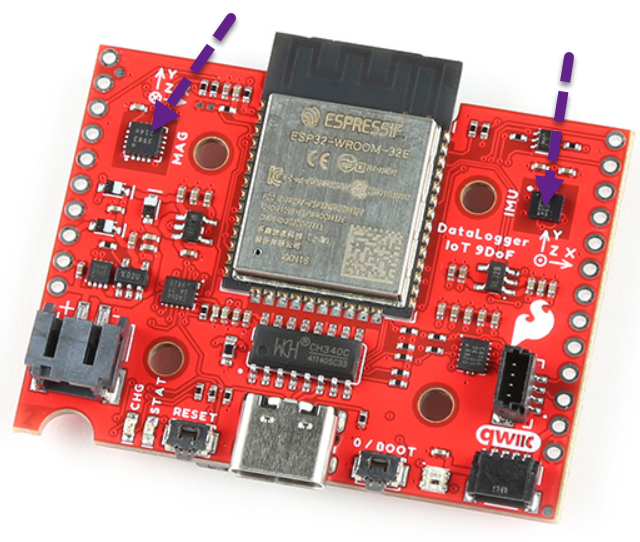

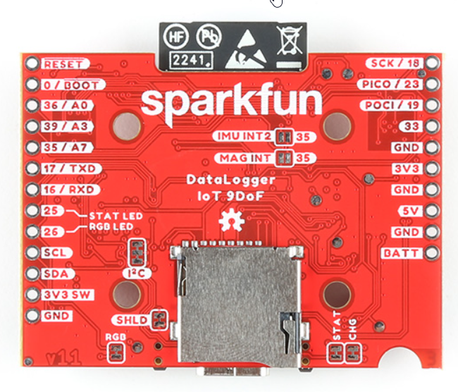

What about this hardware? SparkFun DataLogger IoT - 9DoF DEV-20594
It's has the 4bit sd-card what is now supported by FC10.
And on board is a IMU ISM 330 DHCX on SPI bus and a Magnetometer MMC5983MA.
It's support the interupt on the IMU.

ESP32 Board with ISM 330 DHCX MMC5983MA:
Demoboards IMU ISM 330 DHCX on SPI bus or i2c and a Magnetometer MMC5983MA:

I have the board now. I can compile and let a Led flash.
Just the SD card make a small problem.
I can not init the sd-card.
There is no pin to choose for the card?
Fixed Pin on hardware....

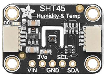

And I also use this multiplexer together with 8 pieces Sensirion SHT45
so it's simple to connect with QWII cable....
8 Channel I2C multiplexer:
https://www.digikey.ch/de/products/deta ... gCwgF0BfIA
https://www.digikey.ch/de/products/deta ... 5/17831054

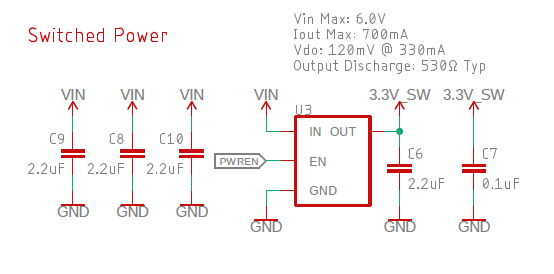

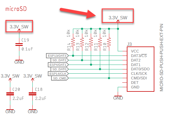

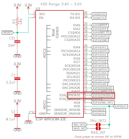

I have to set GPIO32 to high, to set power on for the RGB LED and the micro-sd card.
Sorry
here is a powerswitch to turn on 3.3V_SW. with the pin PWREN
on the esp32 GPIO32
on the card:

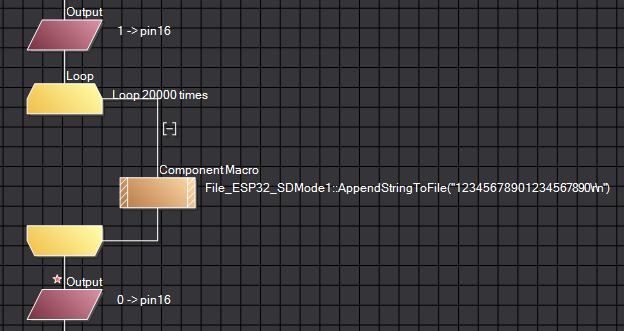

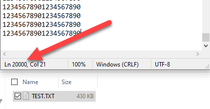

The 4 bit mode is working fine also with 40MHz clock! cool!
I made a test to append 20'000 string, each string was 20char (and 2byte cr and linefeed)
To test the time I used a hardware pin connected to my Oscilloscope, so it took 1 second

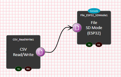

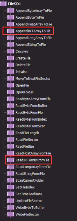

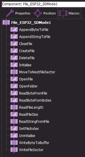

Now my question. would it be possible also to have AppendINTArray and ReadINTArray like the the "spi" FAT?
I use this mostly to store data in binary form.
Command for FAT File SD
simple test part:
good result all the 20'000 lines:

To write binary data is a little problem.
write byte to buffer is not working
and AppendIntarray does not yet exist. I would like to use this AppendIntarray for data.

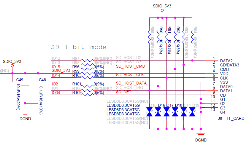

I'm trying to get the 1bit mode working with a display SD card (a14 SCK, a15 MOSI and a2 MISO) - but no joy.
I get
E (5884) sdmmc_periph: sdmmc_host_clock_update_command(200): sdmmc_host_start_command returned 0x107
E (6884) sdmmc_periph: sdmmc_host_clock_update_command(200): sdmmc_host_start_command returned 0x107
E (6884) sdmmc_req: handle_idle_state_events unhandled: 00001000 00000000
E (10894) sdmmc_periph: sdmmc_host_clock_update_command(200): sdmmc_host_start_command returned 0x107
E (10894) sdmmc_common: sdmmc_init_ocr: send_op_cond (1) returned 0x107
E (10904) vfs_fat_sdmmc: sdmmc_card_init failed (0x107).
Kicked out as debug. What I'm trying to do might not be possible - but I found this:
At the same time, many LCD breakout board also breakout a full size SD card slot. However, most of them only break out the SPI mode pins. It is not enough to use as 4-bit SD bus mode, but you can still use it as 1-bit SD bus mode by this connection mapping:
LCD -> ESP32
SD_CS -> nil
SD_MOSI -> 15
SD_MISO -> 2
SD_SCK -> 14
Any suggestions to as to whether this is either possible? or what I am doing wrong?

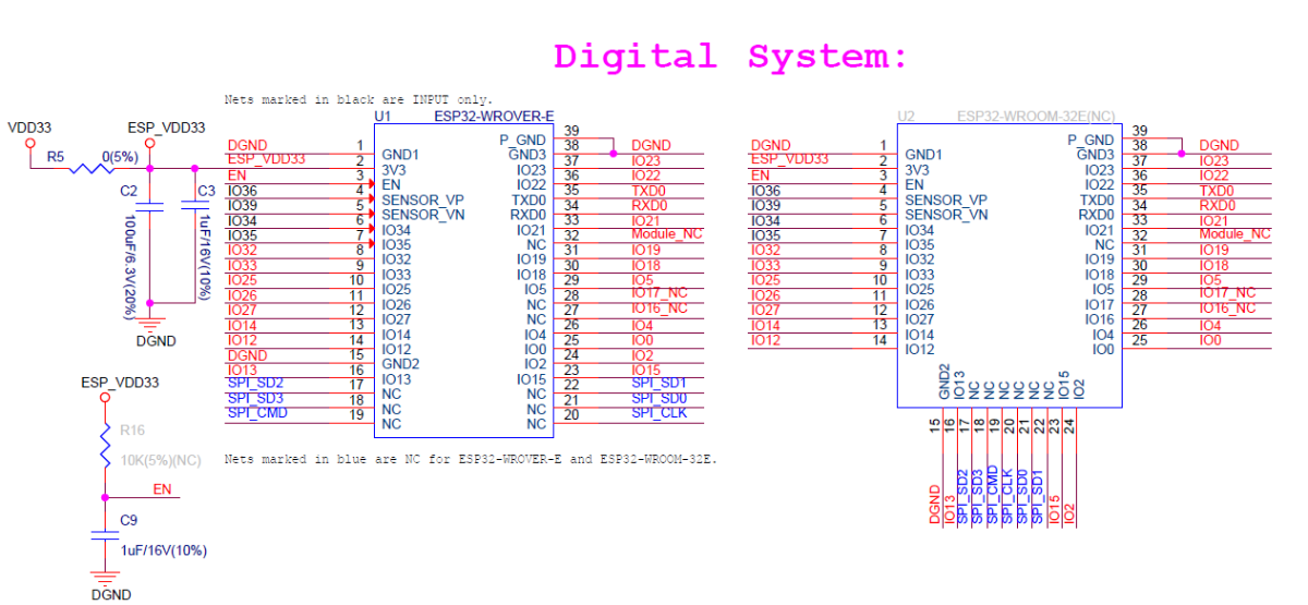

Yes some of the ESP32 kit has a 4Bit mode.
Only which one works is not clear to me.
In the schematics, connections are marked blue or gray, perhaps because one ESP32 or the other ESP32 soldered assembled
At the moment I continue to use the sparkfun loger. It works well there. I hope the component will be extended a little and allow a simple replacement.
You should be able to use any SD card with 1 bit mode.
Can you let me know which hardware you are using and I will see which pins do what.
not clear to me:
not clear to me:
A way to use 1Bit Mode with 4Bit connection:
