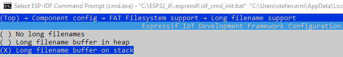

I have found a setting in the ESP32 S3 setup.
somehow it should work

That setting could work with the ESP32 specific SD mode component which uses the IDF libraries. I don't think I do anything to force it to be in the 8.3 format.

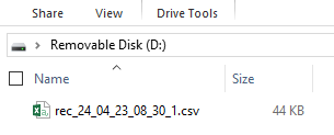

This is a great advantage for my recorder.
It's working nice, Flowcode, File_ESP32_SDMode1 and longfile name.
Even if I don't know what heap or stack means. Both settings work fine

As per the Stack/Heap setting I found this info. Both are in RAM but it's probably the top vs bottom of memory. Probably stack is the better option.
The stack is generally used for storing small, short-lived variables such as local variables and function parameters, while the heap is generally used for storing larger, longer-lived objects.
