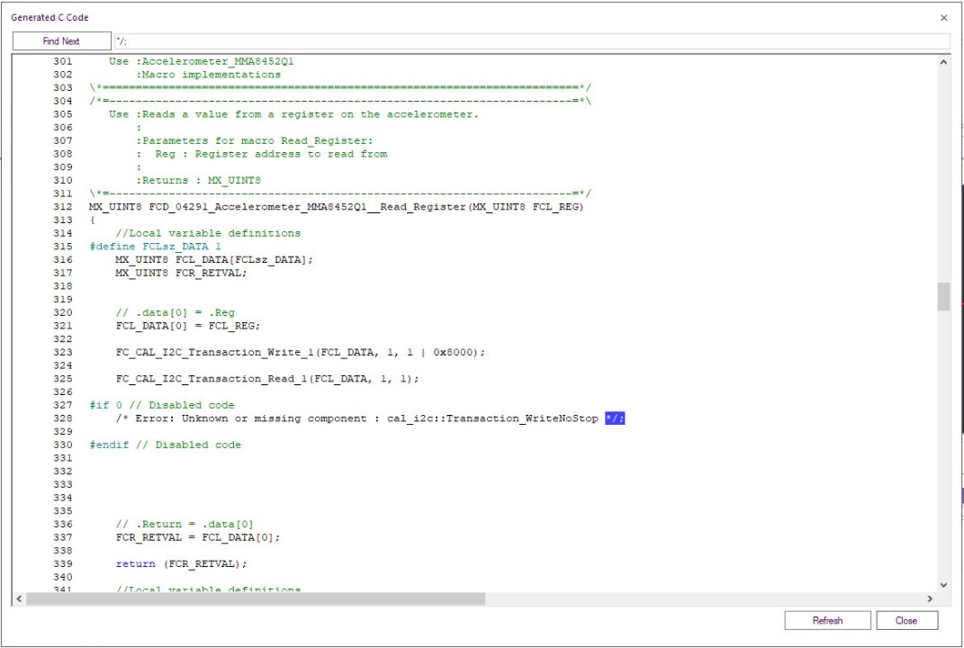

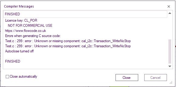

I use the MMA8452 with the ATtiny2313 microcontroller (and tested with pic16f628a). I get an error message when generating code C. I may have found an error, see the attached screenshots

Thank you for the spot.
I have replicated and fixed the issue, and the component will be pushed onto the update system as soon as possible.
If you would like to try the components before the updates are pushed.
Browse to this location using file explorer, it's hidden by default so just paste the link into your address bar.
C:\ProgramData\MatrixTSL\FlowcodeV9\Components
If you run any component updates, then the components you added will be overwritten with the updated version.
