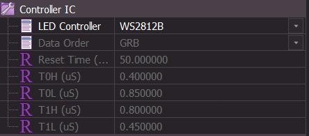

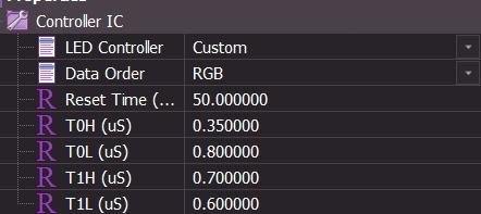

Also what do you do like in our case when we have 2x totally different components effectively (but in Flowcode is the same one):
1x WS2812B component (standard setting): which is GRB encoded and drives 5V WS2812B LEDs directly)
1x WS2812 component (custom setting RGB as below): configured to communicate with RGB driver WS2818B which is effectively RGB encoded instead of GRB driving 12V LEDs
