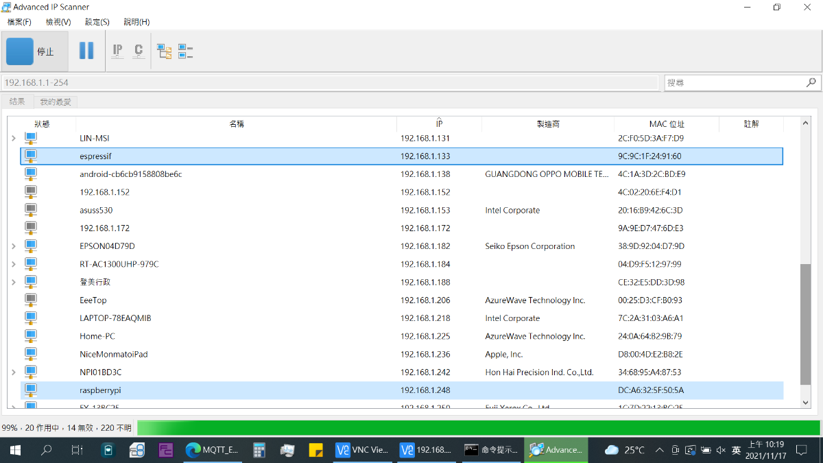

Picture_2是我的 Rpi 設置。(MQTT 經紀商測試和 IP 位址)

If It was me,
The first thing I would do is check that both the ESP32 and RPI can be seen on the network.
I would use a network utility tool.

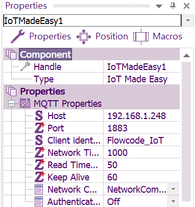

Then I would check that RPI IP matches up with the stated IP within IOT Made Easy component.
As you have set up a broker name and password, within IOT Made Easy (Pi,a0953530662), have you set up the same name and password within the RPI?

Reply to medelec35 :
First, thank you for your reply. I followed your suggestion, check my hardware.
(1) Rpi and ESP32 both can be seen on the network.
(2) Rpi IP address matches up with the stated IP within IoT Made Easy component.
(3) I found I didn't set up the broker name and password, so I changed the component properties.

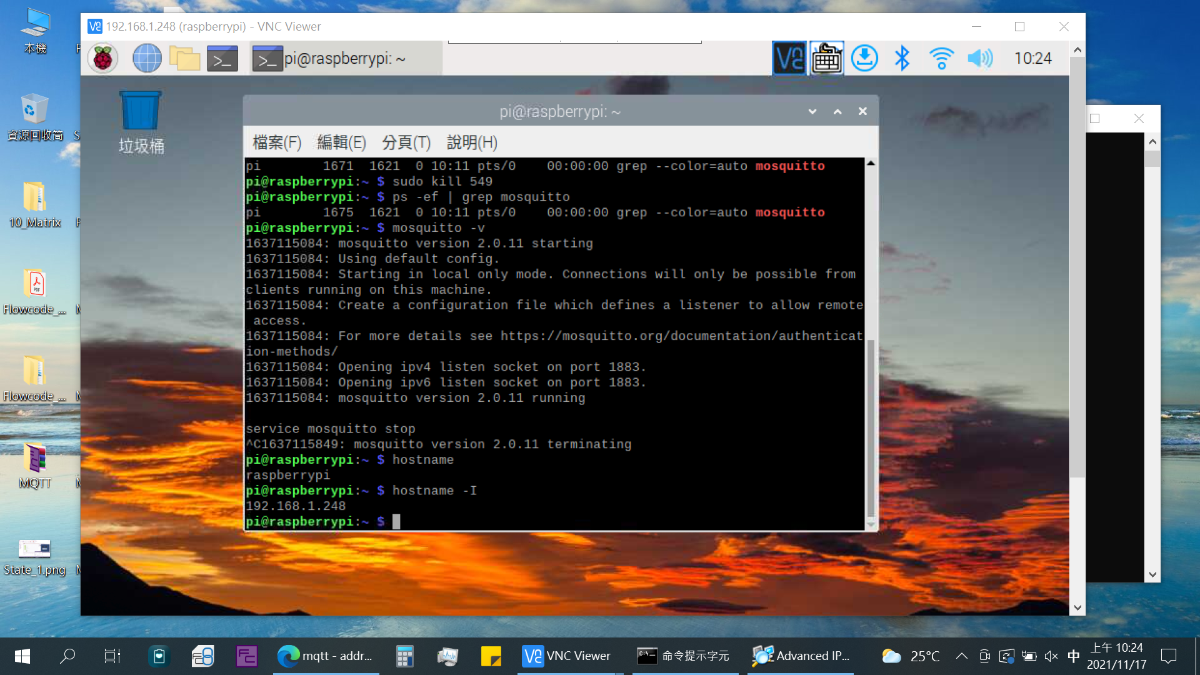

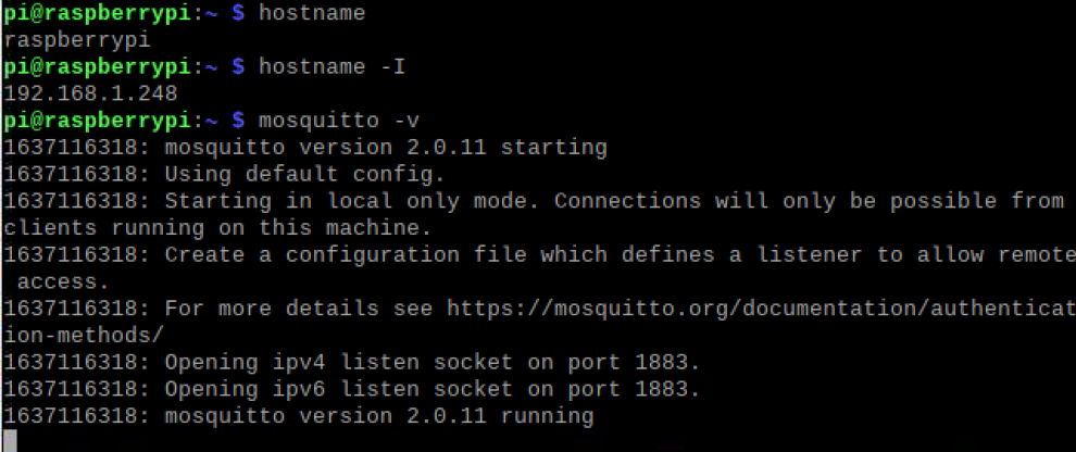

Thanks you for you reply!
This was the screen message, is it got some wrong ?
Re: MQTT_ESP32_AppDev did not work.
Posted: Thu Nov 18, 2021 11:12 am
by BenR
Mosquitto version 2.0 and after requires a bit of additional configuration to enable remote access.
The clue is the "starting in local only mode"
The details are available here.
https://mosquitto.org/documentation/aut ... n-methods/
