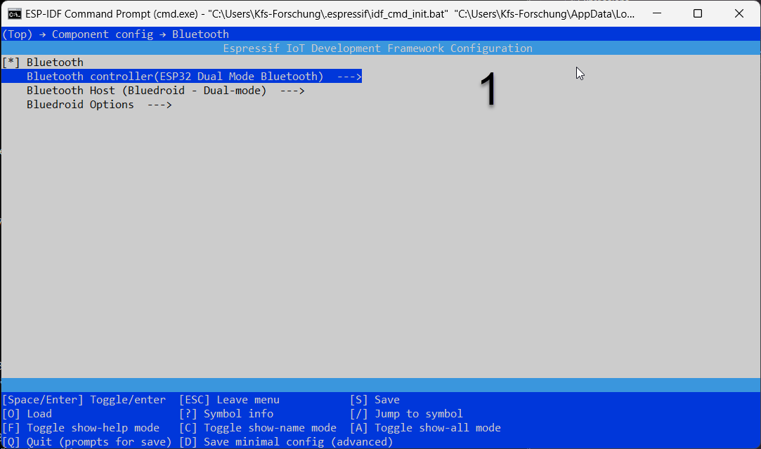

The only additional thing to do is to enable the legacy bluetooth in the config settings. I'll see if I can dig out the info for you on how to do this.
Hopefully the config is already correct but let us know if not,
Details here.
viewtopic.php?p=53#p53

Here is an info about how to config for Bluetooth SPP from ESP32 and Flowcode.
It only looks complicated, but it is simple
I hope it's help a litle...
How to do it....
ESP32_Bluetooth_Flowcode.pdf
(474.01 KiB) Downloaded 320 times
Config Progam:
