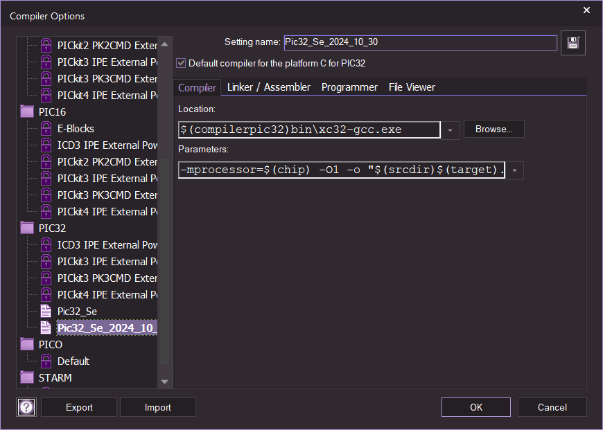

Hi Martin
I suspect my compiler options are not correct.
I am using the PIC32 on my own hardware.
That works fine. But what settings should I use for the bootloader?
Could you export your settings and post them?
I will then adjust the paths.

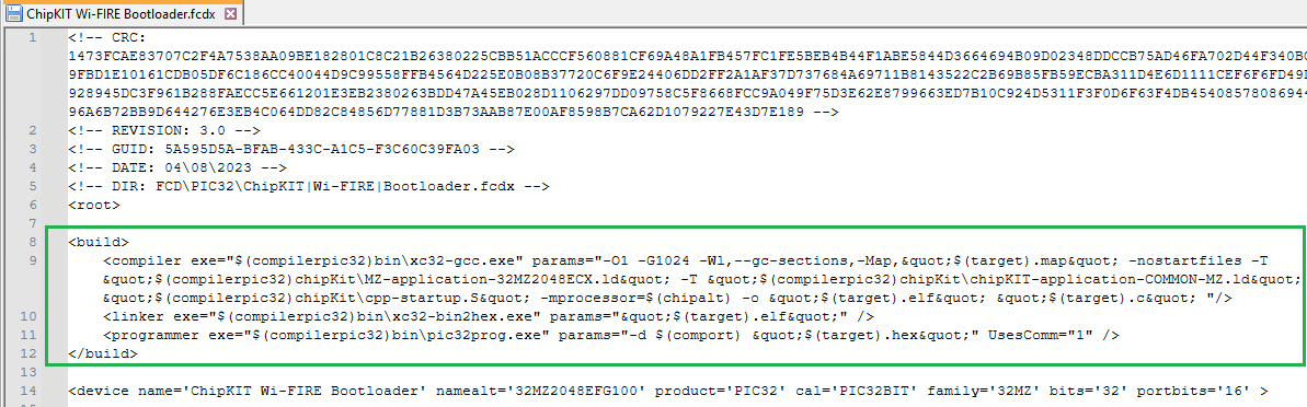

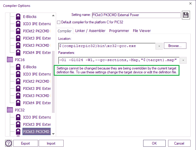

Re: PIC32MZ Board chipKIT Wi fire Bootloader
Hi Stefan.
When you select a target device that has a boot loader e.g. your ChipKIT Wi-Fire Bootloader, or Arduino Uno etc then the compiler settings for the target is taken over by the relevant .fcdx file.
Therefore you should not have any compiler setting selected like you have.
Compiler settings1.png (42.02 KiB) Viewed 3622 times
Compiler settings2.png (53.19 KiB) Viewed 3622 times
Hi Martin
I changed to the same setting as you and now it works. It even works very fast for flashing. Thank you very much.

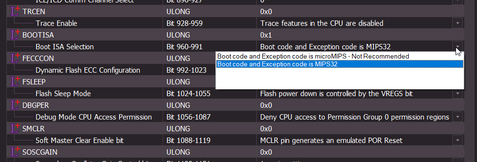

But there is still a small problem with the PIC32MZ.
If it is set to microMIPS, the interrupts no longer work properly.
With the processor target PIC32MZ this is very easy to change.
Do you know how I can change this on the target bootloader Wi Fire?
Fc8_usb_Bootloader1_IRQ.fcfx
(20.64 KiB) Downloaded 137 times
Posts: 1944
Has thanked: 508 times
Been thanked: 691 times
The bootloader firmware would probably need re-writing with the configuration bit altered. Do you have access to the bootloader source code?
