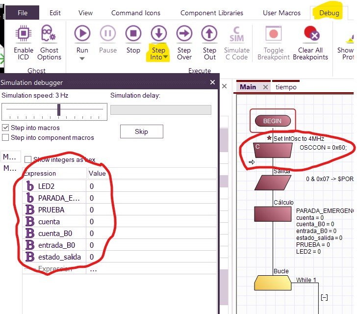

Now a problem has arisen that I have been observing for a long time and that in this project has occurred again and I don't know why it occurs:
When I have a switch activated at a low level, many times when starting to run the program, in siulation, the first time the state of the switch is read it is never recognized by the state. That is to say, when starting and reading the status when active at a low level, it should read a 1 and yet it remains reading a 0.
For it to work, I have to enhance a pulse and then it always works correctly.
This effect is currently happening to me in the project converted from version 5
What could it be due to?

Just heading out but try simulating and Step-Thru. Monitor your variable and you will see where the issue lies (hopefully). Note that v11 initialises variable to "0" if you don't.
Posts: 1955
Has thanked: 425 times
Been thanked: 647 times
Re: Update project to F10
Post by chipfryer27 »
It looks like you are running on the internal oscillator, but have forgotten to include the necessary C-Code to enable such. You can see I have included it in the attached.
I simulated by going to Debug>Step Into.
You will see the C-code circled and I'm monitoring all variables
Screenshot 2026-02-07 170922.jpg (100.28 KiB) Viewed 763 times

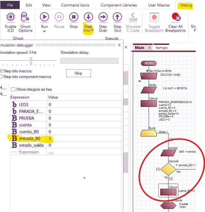

Stepping through on first run, you can see the variable change state correctly.
Screenshot 2026-02-07 171246.jpg (85.52 KiB) Viewed 763 times
The program stays in that branch until the switch is activated. Note that when you switch, the branch enables a timer interrupt for as long as the switch is activated. Timer interrupts do not simulate very well on a PC as your PC is running far, far faster than 4MHz and your PC is doing a ton of stuff in the background. It should be OK on hardware.
