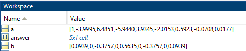

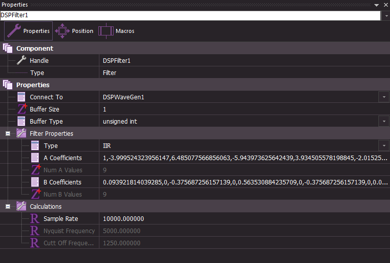

To get the coefficients in Matlab looks easy.
https://www.mathworks.com/help/audio/re ... oeffs.html
just copy the coefficients A and B from here
And insert it in the flowcode component simple with copy/paste
[1,-3.99952432395,6.48507756685,-5.943973625,3.934505578198845,-2.015250091,0.592300881508,-0.070800793989557,0.017664812652882]
Just remove [ ]
Ok soon I will test it in the hardware.
