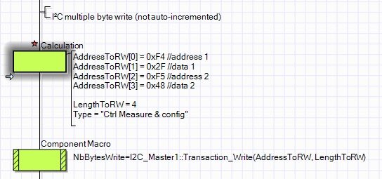

hi,
Is it possible to write 2 values to 2 different address with only one transaction write ?
for example: write 0x2F to 0xF4 address then Write 0x24 to 0xF5 address
thx for your prompt reply
I'm talking for same device but at 2 different register address

hi,
It tried I²C multiple byte write (not auto-incremented) and it work well.
Capture d’écran 2022-02-09 082417.jpg (33.14 KiB) Viewed 7134 times
address 1 to write is the 1st byte of AddressToRW and data is the 2nd byte
address 2 to write is the 3rd byte of AddressToRW and data is the 4th byte
auto-increment is not working with my device
Re: I2C can not read more than 20 data in one time
Posted: Wed Feb 09, 2022 7:39 am
by mnfisher
That's good..
If the device allows then it will work...
