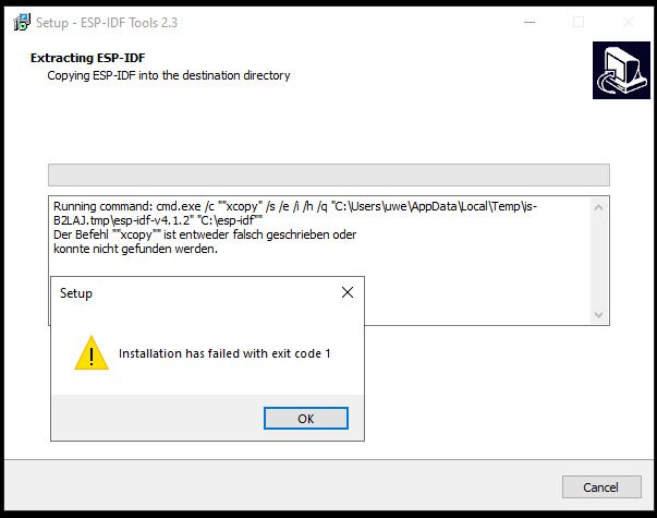

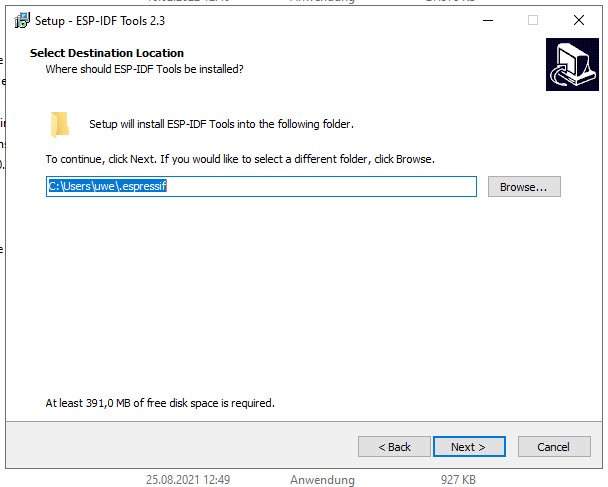

Re: Problem with the installation ESP32
Posted: Sun Feb 20, 2022 6:57 pm
by SpeedPIC32
Hello medelec35
tried to install the suggested versions and got this error again.
greetings
SpeedPic32
Fehler neu.jpg (31.32 KiB) Viewed 8652 times
Posted: Sun Feb 20, 2022 7:14 pm
by medelec35
Do you have an antivirus running that could prevent files from being copied?
Posted: Sun Feb 20, 2022 8:59 pm
by kersing
xcopy missing? Which Windows version are you using?
Posted: Tue Feb 22, 2022 2:12 pm
by SpeedPIC32
i am using windows 10.
can't the error also come from the installation routine?
I have found Xcopy several times on my computer.
Greeting SpeedPic32
Posted: Wed Feb 23, 2022 9:01 am
by SpeedPIC32
Hello Matrix Team
I cannot install ESP32.
No matter which file I use, it no longer works.
Should I uninstall everything including FC 9?
I need professional help now.
Error code 1 means that there is no file to copy in the directory.
The complete content of the location esp-idf should be in there.
Greetings SpeedPic32
