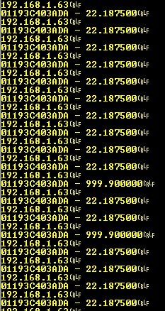

I have managed to replicate the problem but only ocasionally, for me the data is correct most of the time and every so often it is corrupt when the WIFI is active. Out of interest what value of pull up resistor are you using? It could be linked with network activity or how much data the ESP32 is transferring so maybe there is a way to create a pause in the data flow when you are sampling the temperature. It might also be worth monitoring the VCC and see how stable that is, e.g. if the WIFI comms is causing ripples or dips in the supply voltage due to lack of current.
I tweaked the timings in the OneWire component to try and correct the problem but it didn't really make any difference.
I have added a new property to the DS18B20 component which enables CRC checking so now if the data is not correct and the CRC is not a match we return 999.9 instead of an unknown value. This should mean you can rely on the temperature readings you do get. I'll roll this out to the other one wire temperature sensor components.

I fitted a 1K no difference , how I'm controlling the ESP32 is through app developer I have 2 probe's and i can switch between the max6675 and the DS18b20. What I have just noticed that if I only initialise the WLAN and the network comm's it reads reads and then every now and then I get the 999. But when I initialise the ModbusTCPSlave that's when all goes to hell and all I get is 999. When I look at the signals on the scope of the one wire it looks very clean so not sure whats going on. It seems to be something in the ModbusTCPSlave can PM both programs to you if you like

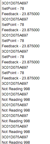

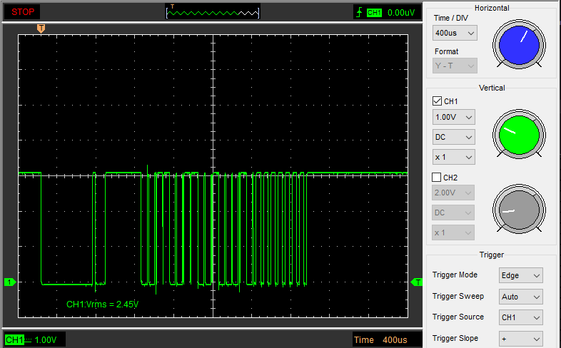

I am totally confused with this, When I start the program running and I have WLAN, networkComms & ModbusTCPSlave initialised sometimes it runs for a short while then stops then I need to remove power leave it off for a about 20 second then power up and sometimes the system restarts some time not. If i disable the WLAN, networkComms & ModbusTCPSlave and run the system It runs forever.
Running then stops working
picture of the comms on the probe when it has stopped working
scope shot DS18.PNG (36.21 KiB) Viewed 6715 times
Whats also strange is that when I flash the NodeMCU ESP32 after it has stopped working and fire it up again it still dos not run until I remove the power leave it off for a few seconds then power back up. I though it could be the module so I have tries another one and I have the same results
