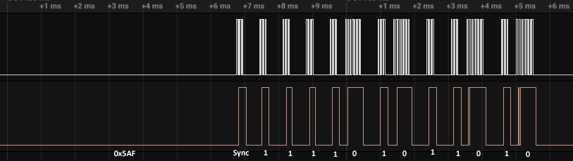

Top trace is the TX data and the bottom trace is the RX data.

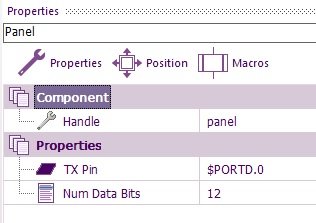

The TX/RX pin is set via one of the top level properties as is the number of bits to send/receive.

The pin is provided by the top level properties, either click on a blank area of the panel or use the drop down at the top of the properties window.

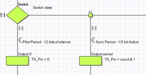

The pin is driven inside the TimerInt macro as part of the state machine. The TimerInt macro is called by the timer interval component on a regular interrupt driven tick.

I'm also afraid you can't connect the TX MCU pin directly to the RX MCU pin, if you look at the original image I posted with the TX example you can see the TX pin is modulated and the RX pin is clean and unmodulated. This demodulation is done for you by the receiver hardware.

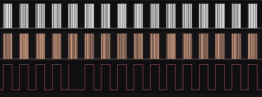

I've managed to tweak things and get them a bit more stable now. Rather then picking up say one in twenty packets we now receive most packets correctly. There's still the occasional loss of data due to a smaller then usual sync pulse and so the RX interrupt could be run a bit faster to overcome this.
Here we have TX data top, RX data middle and RX decoding bottom, most packets are decoded correctly but the dropped packets can be seen by the spike.
Here is my current RX project with a bit of debugging using pins B3 and B7. As I say decreasing the timedInterval delay slightly should make the data reception even more reliable at close range.

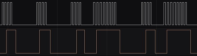

Here is the modulated TX vs demodulated RX data.
