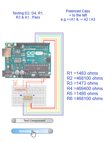

Test Hardware1.png (80.95 KiB) Viewed 12151 times

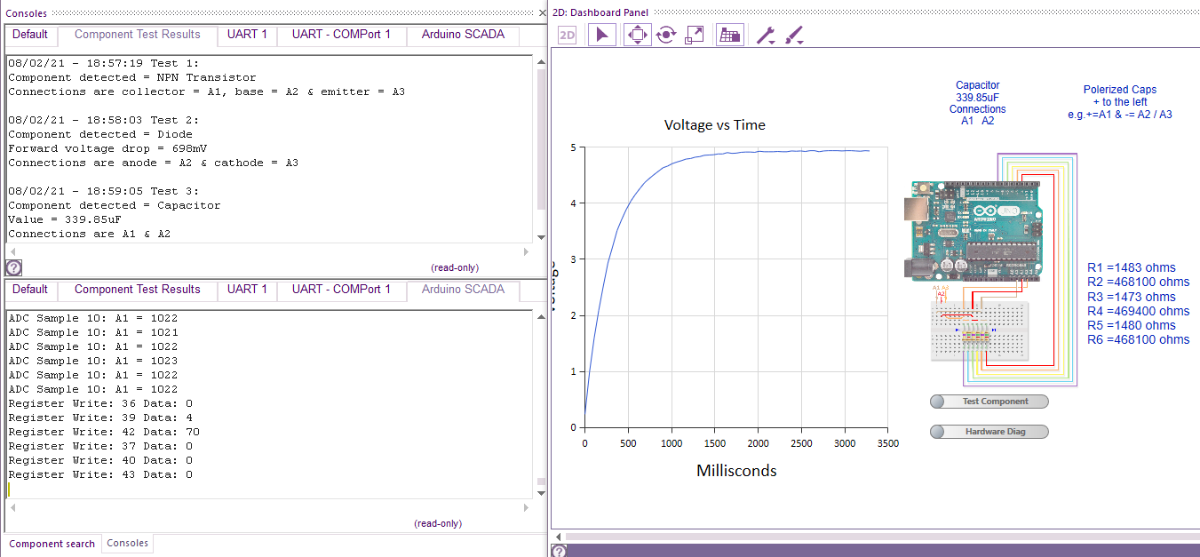

There is a console window for logs of tests carried out:
Bipolar transistors NPN & PNP (can connect any lead to any connection)
Single diode
Dual diode.
Resistors
capacitors
Instructions for use:
Load Arduino_Uno_SCADA_Firmware.fcfx and send to an Arduino Uno
Load Component-Tester- Rev 1.0.fcsx
Right click anywhere and select properties.
Click on the area in-between the Resistor values (R1 to R6) and XY chart.
You should see within properties shape_rectangle5
Within Image of properties Select the down arrow, and browse to the attached Arduino & Breadboard3.png
This will also contain the circuit diagram for the additional 6 resistors.
Try and match the resistors shown.
Measure each resistor then enter values on the properties of the 2D panel
Also within 2D panel properties you will need to select the correct comport for the Arduino UNO.
Test hardware by linking A1, A2 & A3 together
Click on Hardware Diag.
If hardware is ok (will not test for wrong entered resistor values) the app developer will return to the main starting point.
If there is an issue with hardware, then testing will halt for you to correct the issues indicated.
