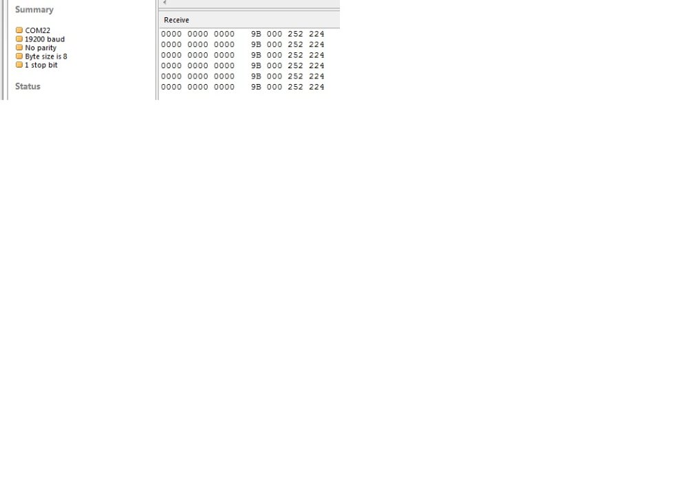

I think I have the port moved now, I still cannot see any data but I am wondering if I am using the correct command.
When I plug in to a PC and use a terminal program I get this, the data I am interested in is the 3 lots of 4 on the left.
serial terminal.jpg (27.54 KiB) Viewed 5669 times

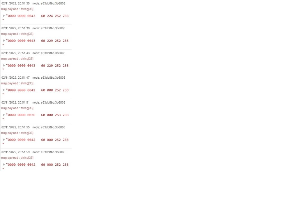

and this is what it looked like on the Raspberry Pi with NodeRED so I am pretty sure I should be using the Receive string option.
Data string.jpg (39.66 KiB) Viewed 5669 times

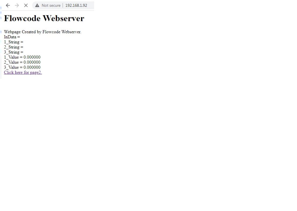

I do not get anything at all, this is what I see.
No input.jpg (26.5 KiB) Viewed 5669 times

by LeighM
Hi Bob,
I've just had a quick look at your Flowcode and the generated C.
Some thoughts ...
The UART Receive String timeout is limited to 255ms (8 bit variable), hence you need to reduce the 5000.
So I suggest that you reduce to say 200ms and then test the return string for being non-null i.e. InDataString[0] != 0
before you go on to process it.
Maybe check the string length too, just to check you have all of it.
Not sure if your buffer size needs to be a little bigger, due to terminating null or CR/LF etc.
I bit of headroom is always useful :D

by LeighM
Hi Bob,
The first character of the string will be '0', but this is 0x30 (or 48 decimal) not 0. Have a look at an ASCII table.
A 100 or 200ms timeout will be fine for a data string every 4 seconds.
Most of the time the receive string will return the null string (first byte 0x00, not the character '0')
If you make the buffer say 40, (looks like minimum needs to be 33+1 for the string null terminator) then you will get the full string
and the timeout will cause a return from the receive string function 100ms after the last character.
So this should synchronise well.
