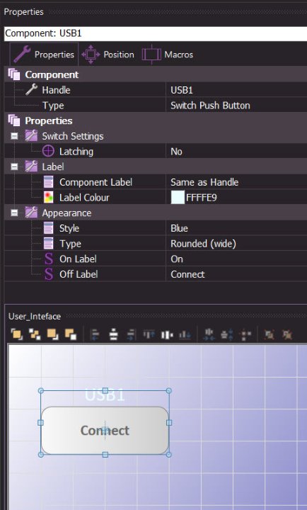

I used a Switch Push Button in App developer some time ago. Now I would like to use this Switch Push Button again in another APP but I can no longer find this component. I renamed the handle but I should still find Switch Push Button as a component?
Switch Push Button
Re: App developer more Button
Posted: Wed Jan 18, 2023 5:11 pm
by BenR
That looks like v10 and one of the new 2D only panels, which was the original switch you were using and was it an old 3D component?
On the Comp Libraries toolbar there is a 2D/3D filter at the left hand side, check this is set to showning all components.
The Search may also be also to show any components that have been dropped from the component categories. I am yet to re-organise the AppDeveloper cats for v10 so hopefully I can do this later this week.
