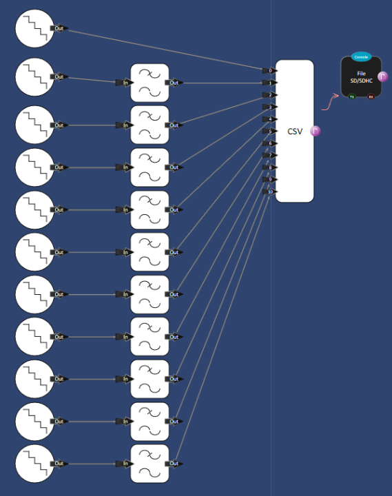

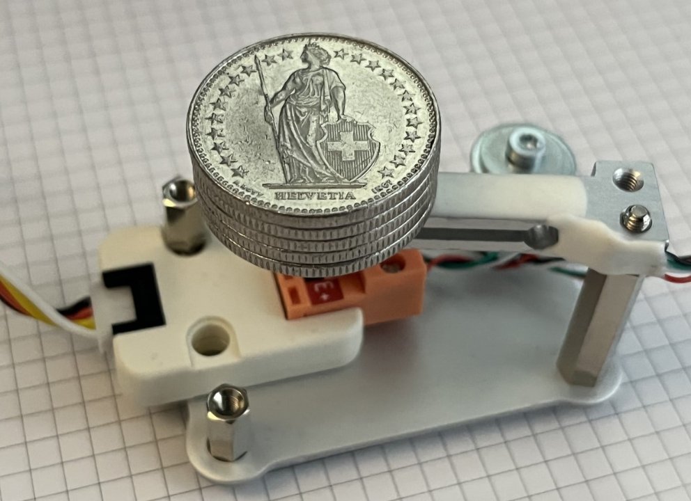

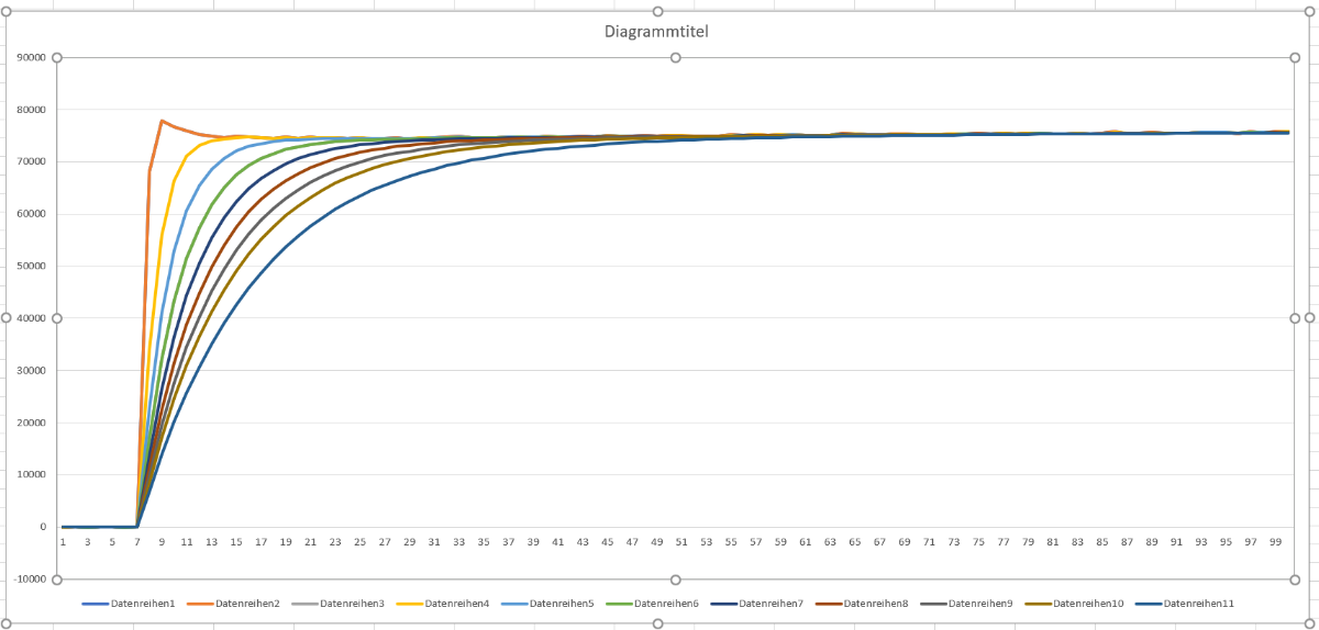

I did a test with 10 DSP filter
Filter 1 has coeficient 1
Filter 2 has coeficient 2 .....
The signal is from a HX711 and a strain gage. After 7 Sec I load some coins on the straingage and after 100 Sec I stopped recording
It's working perfect.
Just not so fast.
Now tried to use array
Test Adapter:
Filter and raw Signal:
Open in Excel and add all in a Diagramm

Excellent glad it's working and love the results. Many thanks for sharing.
Also those coins look pretty cool 8-)
