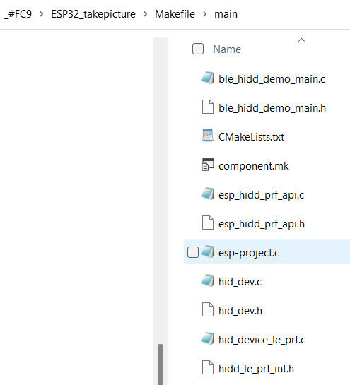

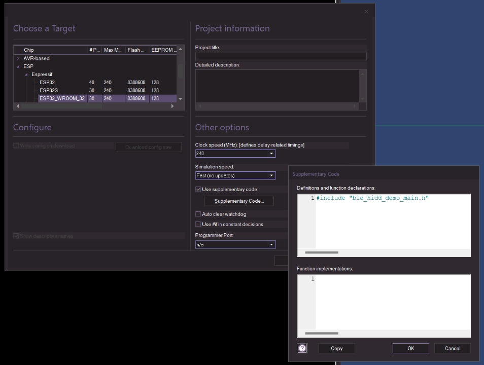

Hi Martin
Before I compile the Keyboard.fcfx
I would like to ask you in which folder I have to copy the file Keyboard.fcfx.
The program needs an include file "ble_hidd_demo_main.h"
Does this mean that Keyboard.fcfx .. should be copied to the same folder?

Re: ESP32 Bluetooth command to take a picture
Posted: Tue Nov 08, 2022 1:18 pm
by mnfisher
Hi Stefan,
The fcfx file in your project folder - attempting to compile this (from within FC) will create a new directory with the name of the project (in this case 'keyboard') contents of the zip file to copy to this new directory.

Compile to C is working and give a keyboard.c
Firts time Compile to hex give a error but it creat the main folder.
So I copy the zip files in the main folder and
Second time Compile to hex run bether.

You need to create the project file as per first downloads then update as per second.
1) save Keyboard.fcfx somewhere (say C:\Projects) open in FC and compile to hex (this will fail - no matter it creates the directories needed)
2) copy in the contents of the first zip (to c:\projects\keyboard)- and then contents of 2nd zip file to the directory (c:\projects\keyboard\main)
3) should now be able to compile to hex in fc.
4) upload using idf.py -p COM5 flash (change 5 as required for your com port)
