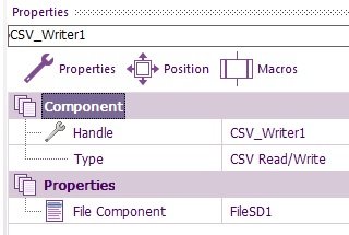

Please can you confirm the CSV Writer component has the File Component property.
If it doesn't then you may just need to update your components via the Help -> Library updates menu
Re: CSV Read/Write or Output CSV
Posted: Mon Nov 14, 2022 3:15 pm
by RGV250
Hi Ben,
I am up to date and it looks the same as above.
Bob
