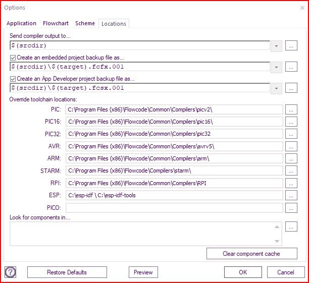

Hello everyone - LeighM -Martin
Look below at the image that shows the Options section ESP.
Is this how you think ESP should be written: ESP: C:\esp-idf \ C:\esp-idf-tools ?
Yours sincerely
Monie
Re: ESP toolcain!
Posted: Sat Dec 03, 2022 3:52 pm
by mnfisher
Hi Monie,
No, it should just be c:\esp-idf
Re: ESP toolcain!
Posted: Sat Dec 03, 2022 5:09 pm
by monie
Hello Martin
Thank you very much for your suggestion for the path to C:\ESP-idf in the Options menu :D
