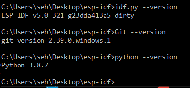

Hi Ben,
thx for your feedback.
Indeed, I did compilation test with V5.0 and failed.
However, install new a IDF version with command below is working well.
git fetch
git checkout release/v5.0
git pull
git submodule update -f --init --recursive
install.bat
idf_tools.py uninstall                          from esp-idf\tools\ directory
idf_tools.py uninstall --remove-archives        from esp-idf\tools\ directory   to remove also archives
idf_tools.py uninstall was not working for me because my directories are not same as yours

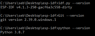

To switch back to 4.1 version,
First need to update Git because switch command was introduced in version 2.23 as an attempt to simplify the process.
git update-git-for-windows
Now the current git version is 2.39.0
then, like you said, following command can be used
git switch -f release/v4.1
git fetch
git checkout release/v4.1
git pull
install.bat
I did a lot of testing and compilation after reverting to version 4.1, it work very well to switch between versions.
like you said,
For existing projects you will have to remove the cache directory located in the same folder as the Flowcode project file to force a complete recompile.
To check idf,Git and python version
idf.py --version
git --version
python -–version
To check ESPTOOL version installed. Last version is 4.4
pip3 show esptool
Thx
