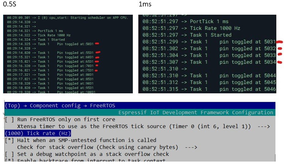

you can also check this prog who is using multitasking of freeRTOS.
it's very fast and accurate too
toggle every 0.5S
Xtask On-Off 1S.fcfx
(17.63 KiB) Downloaded 606 times
toggle every 1ms
Xtask On-Off 1ms.fcfx
(17.62 KiB) Downloaded 640 times
console 3.jpg (113.58 KiB) Viewed 7098 times
do not forget to change Tick rate to 1000 Hz in menuconfig (default value is 100HZ, so min delay is 10ms)
--> Component config-->Freertos--->Tick rate to 1000
then recompile your program

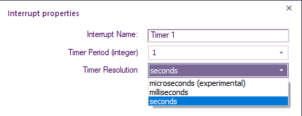

The timer interrupt on the ESP32 is different from the PIC version.
For example you can select:
ESP32 Interrupts.png (7.6 KiB) Viewed 7058 times

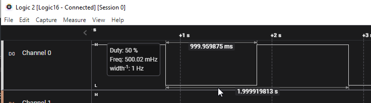

It's very accurate.
For a 1 second timer interrupt:
Analyser Waveform.png (20.73 KiB) Viewed 7058 times
It does need to be noted the simulation will be much faster than embedded.

I've had a quick go at adding ESP32 support to the timer component. There is now a new resolution property that appears for the ESP32 that allows you to specify the resolution of the timer in microseconds.
I hope to have a bit of an IDF dig tomorrow so while I'm doing that I'll also see if there are any additional registers I can access to enhance the resolution.
Latest component should now be available via the library update system.
