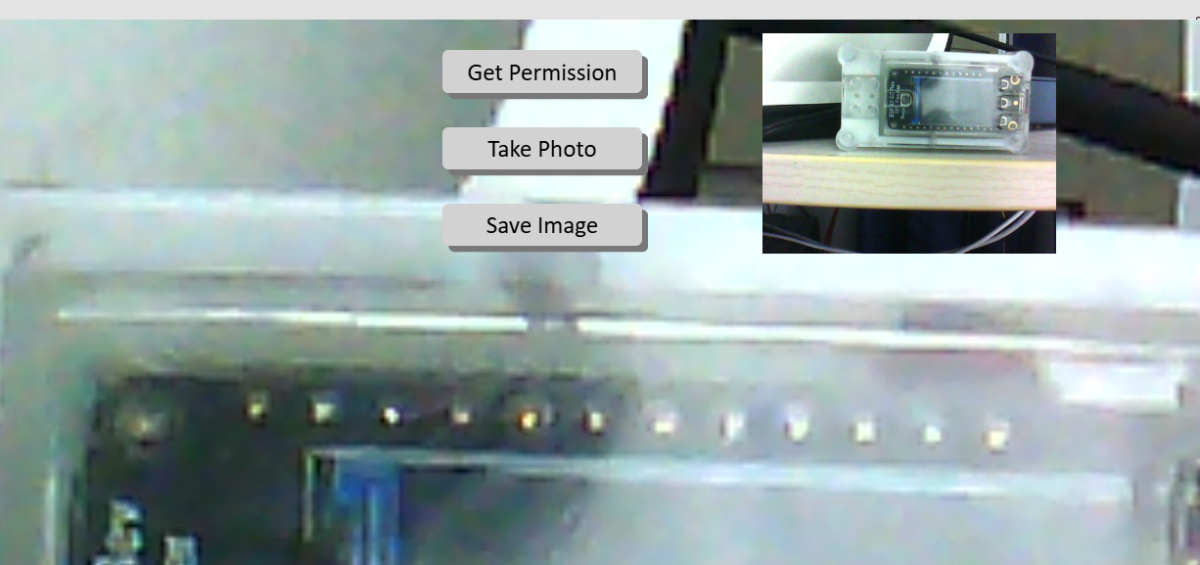

it's working very nice
The buttons can also be placed in the image, also the photo you've taken can be smal in the imagel.
- 2026-06-11_15-00-09.PNG (912.25 KiB) Viewed 1529 times
To save the photo immediately, all I have to do is enter the macro command.

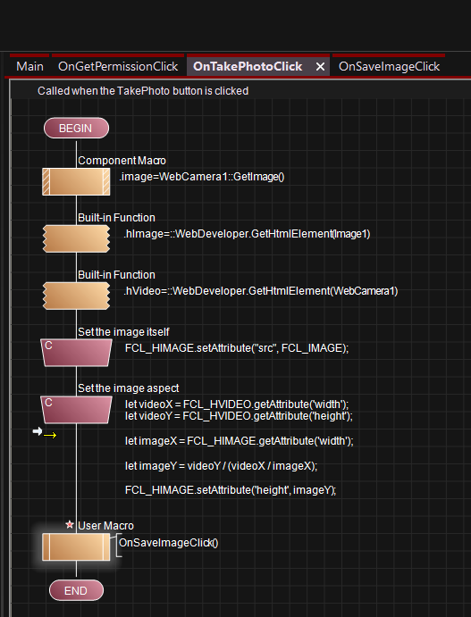

The date is UTC. Here is some code that will hopefully set the filename to the local time. This will replace the code int he first icon in the OnSaveImageClick macro.
var currentdate = new Date();
//adjust for local time
var offset = currentdate.getTimezoneOffset();
currentdate.setTime(currentdate.getTime() - (offset*60*1000));
FCL_SFILENAME = currentdate.toISOString();
FCL_SFILENAME = FCL_SFILENAME.replaceAll("T", "_");
FCL_SFILENAME = FCL_SFILENAME.replaceAll(":", "-");
FCL_SFILENAME = FCL_SFILENAME.substring(0, 19);
FCL_SFILENAME = "PIC_" + FCL_SFILENAME + ".png"
The new lines are the 2 after the comment "adjust for local time".

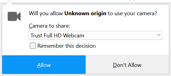

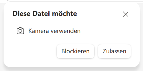

Hi Steve
Firefox ask for permission, and which camera
- 2026-06-17_08-25-28.PNG (17.03 KiB) Viewed 1163 times
Edge ask for permission, but not for which camera
- 2026-06-17_08-26-09.PNG (20.08 KiB) Viewed 1163 times
For the Edge The camera you can choose if you type in edge line_
edge://settings/content/camera

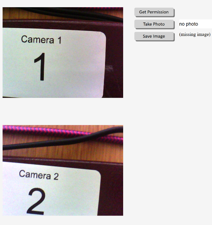

I added a second camera to the Web App
So I can use 2 cameras at the same time
“Record Video” will be missing soon
- 2026-06-17_08-51-35.PNG (537.35 KiB) Viewed 1163 times
