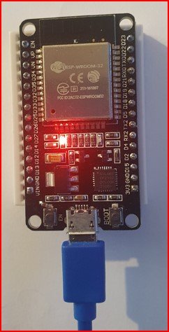

Re: Flowcosev10
Posted: Wed May 17, 2023 9:13 am
by monie
HI kersing
Unit: ESP32 DEUKITU1
See the device connection below in the picture:
Enhed ESP-IDF.jpg (26.66 KiB) Viewed 4089 times
Hope you can see how the ESP-IDF unit is connected :idea:

Re: Flowcosev10
Posted: Wed May 17, 2023 9:25 am
by mnfisher
Try using the esp32 wroom-32 settings in FC - from the stamp on the board looks like it could need this (not sure how much they differ though)
