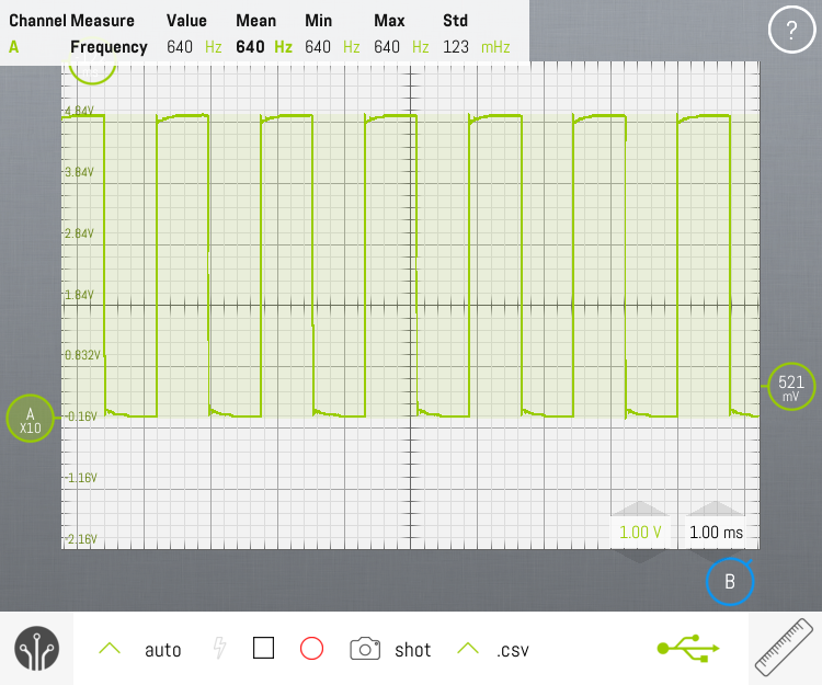

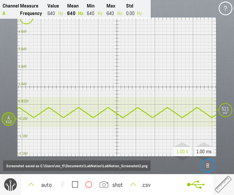

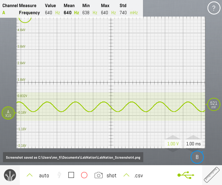

Just tested on hardware - and with a couple of tweaks - seems to work.
So I set CS polarity to Active low and changed Clock polarity to idle high (both in cal_spi properties)
I also changed the first line of the calculation in SetFrequency to
.fword = .frequency * (pow (2,28) / ref)
which may or may not be necessary?
Then I get a square, sine and tringle wave - oddly the amplitude of the square wave is ~5v and for sine and triangular wave it is less than 1v (655mV peak to peak) . The frequency is measured as 640Hz (as set) :-)

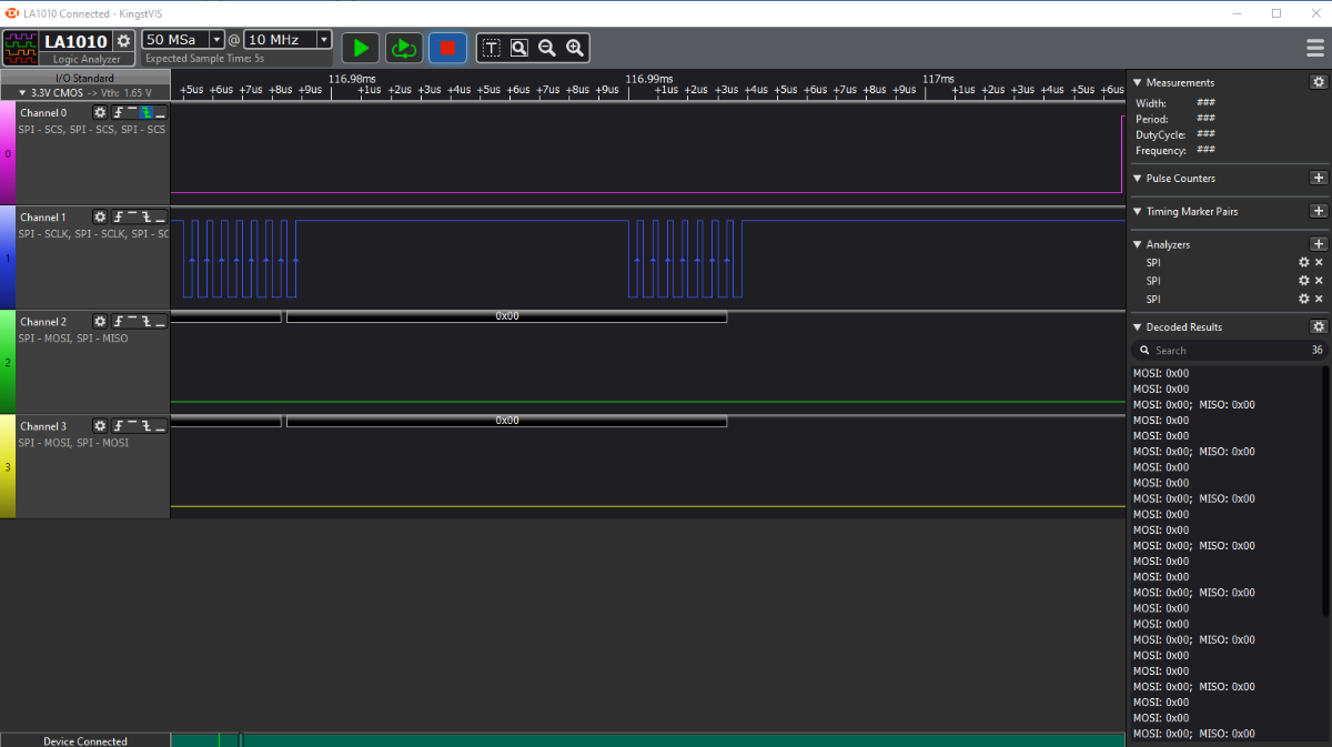

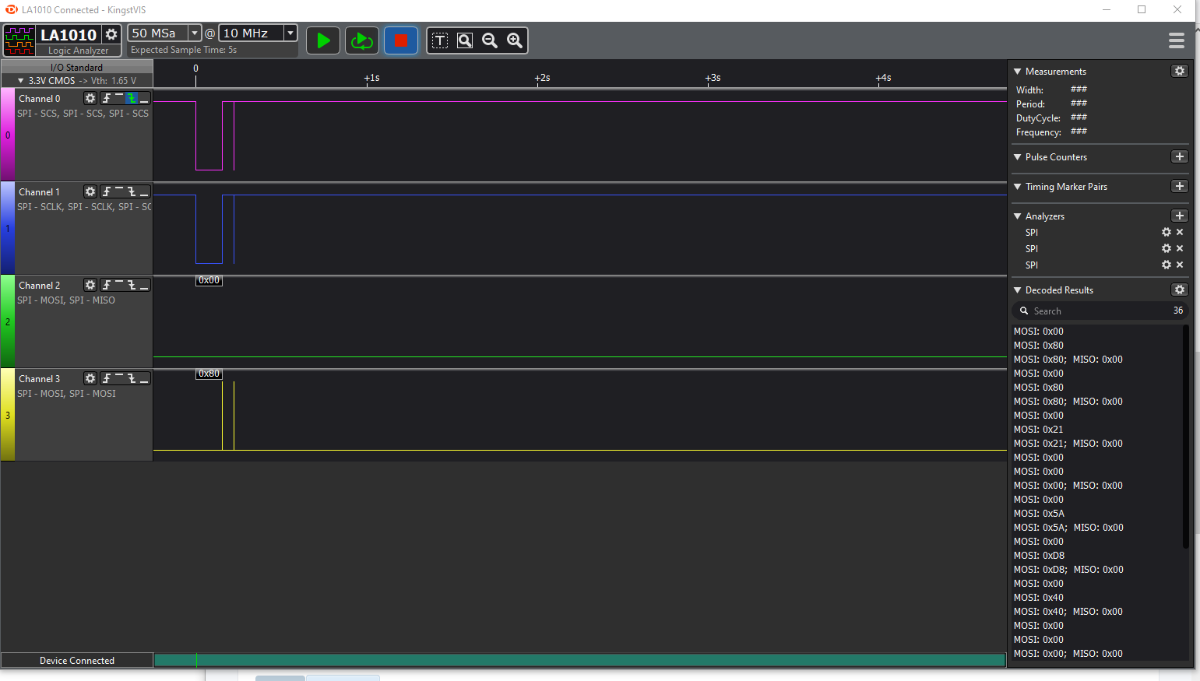

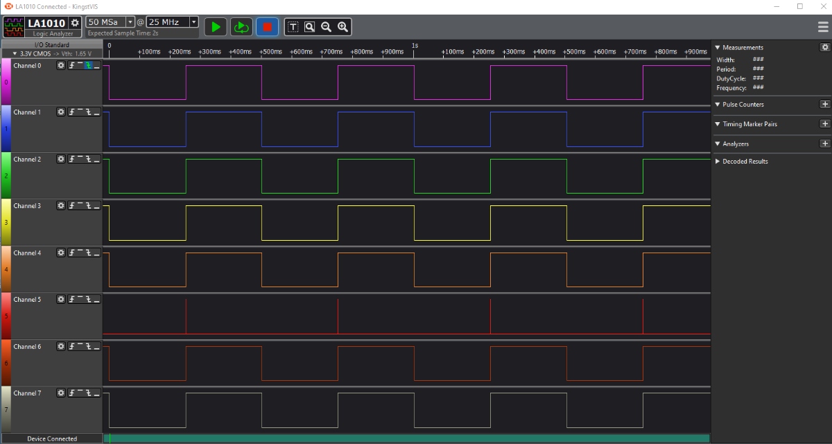

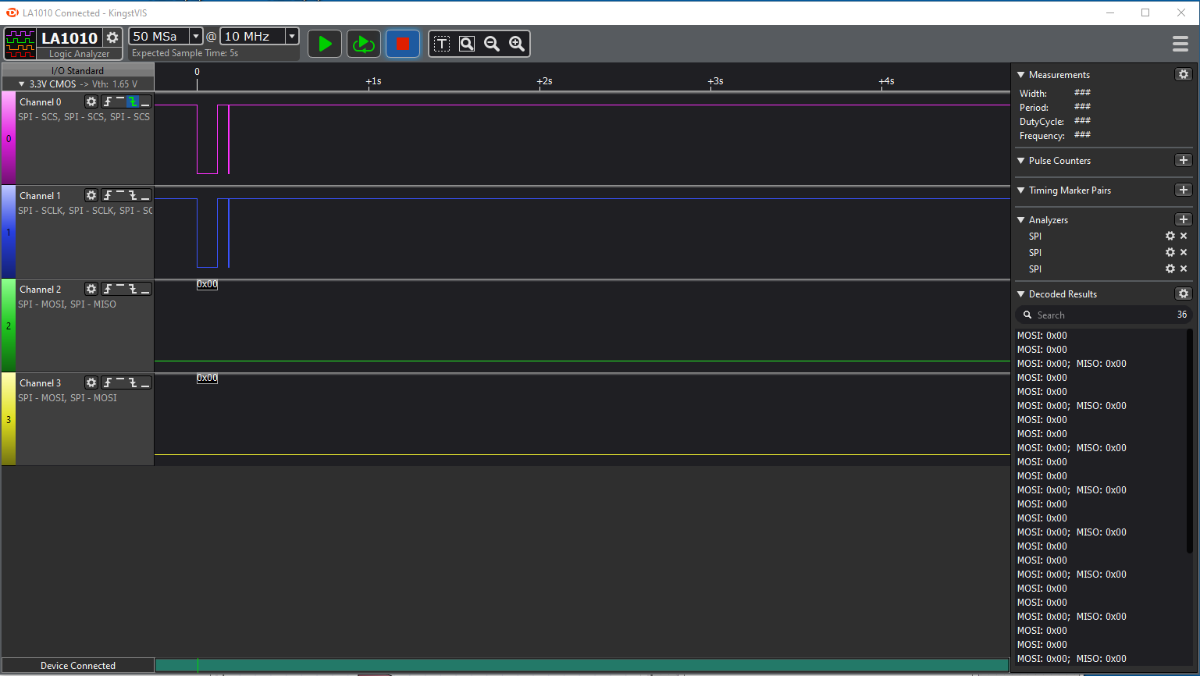

Connected up an analyser to the pins on the breakout board (continuity checked to chip, ~27 Ohms).
Modified Martin's chart for a PIC 16F1939 (coz it was in the BL0080) and put an endless loop straight after he generates the first Square Wave to call a halt to proceedings.
AD833Test_1.fcfx
(18.73 KiB) Downloaded 940 times
Not good.....
Whilst I could see activity on CS and Clock, nothing on the data pins, they remain Low.
I tried using a Software channel (same pins) but no difference.
I then tried a PIC16F877A but that wouldn't do anything not even under mLoader. As that was probably the original chip shipped with my very first programmer from twenty years or so ago, the chip owed me nothing. Using a new 877A (bought in a "Maplin" like store in Australia about 15 yrs ago) it accepted the chart but still no activity on the data pins.
Strange that two chips would display similar issues I swapped pins. This meant I had to use a Software channel, and I put MOSI on C1. This then gave me activity on the Pin. I knew I like Australians...:)
877A Software MOSI-C1.png (135.17 KiB) Viewed 12860 times
877A Software MOSI-C1_Zoom.png (159.69 KiB) Viewed 12860 times
Connecting the module back to the board and running the code, after a bit of faffing with connections I obtained Martin's square wave @ 640Hz.
I have plenty of jumpers obtained from the likes of Farnel which are of good quality but over time these have got intermixed with the stuff that ships with many a cheap module (cheap for a reason) so it's always good to check connectivity.
Next test will be to see if I can do anything with C5... :)

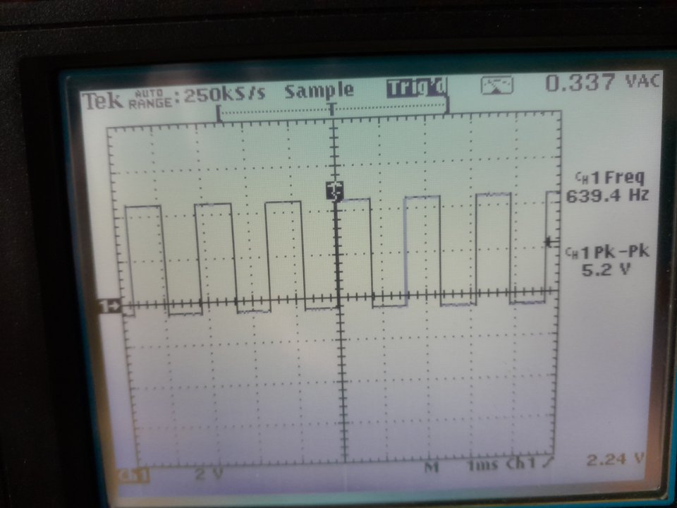

Downloaded Martin's chart (modified for 1939) with all pins as normal (Ch1) and got my square wave. I then modified to run without halt and give each waveform ten seconds before moving on.
Initially the square was stable with a pk-pk of 5.1V but the sawtooth and sine, being only around 632mV pk-pk were quite unstable. This was due to the scope having the trigger set too high. Once resolved each waveform is stable. Well for a module that only costs a few pounds each it's very stable :)
