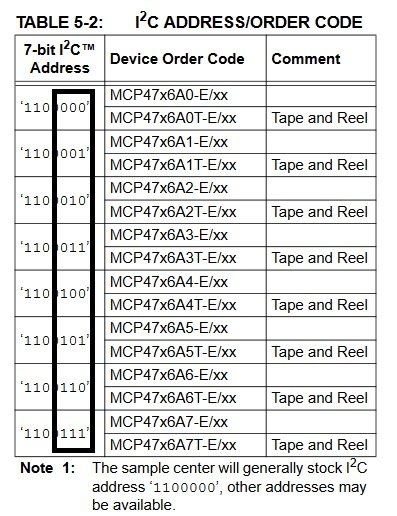

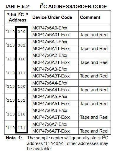

The MCP47x6 datasheet states:
Note: Address Bits (A2:A0) specified at time of device
order
So the address can be any 1 of the 8 addresses.
So you might be selecting a different address that the chip is set to.
What you will need to do is find out what the actual address is.
If you have a logic analyser, scope, or USB to UART converter then the I2C address finder/sniffer[/url] will show you what the correct address is.
Without using one, I don't think you will get any further.
This is what Ben has also suggested.
