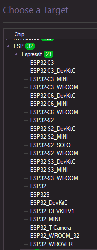

Hi MJU20
Which ESP32 would you like to use?
Not all new ESP32 support the SPP protocol.
List of ESP32
