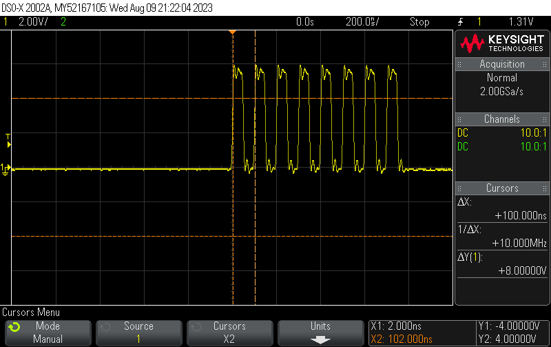

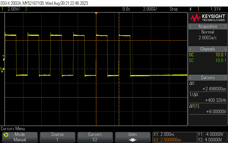

I checked the initial clock speed from the sd-card clock pin and it was 10Mhz (like the display clock)
I actually expected 400khz like the config from the sd-card. So i changed the clock from the display to 400kHz and the SD-card clock was 400khz
and all the 5pcs cards was working.
I put the display clock to 25Mhz and not one card from 5pcs was working.
So I put the display clock to back to 400Khz and all the cards was working.
But it's not so clear... if I set the SD-card 10Mhz and the the display to 400Khz it's not working.
As if the higher clock is used or the 400khz does not work at setup sd-card

I set all the clock to 5Mhz (also the initial clock SD-card) and then it's working :)
And it's a 5Mhz clock

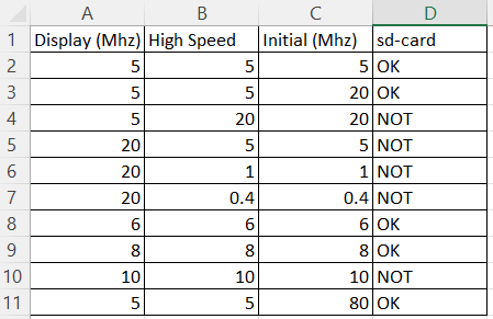

Testresult with different spi-speed

On the ESP32 is still a problem with the (SPI) FAT for the sd-card.
The initial speed properties has no function, so I have to lower the highspeed to the initalspeed to 5Mhz

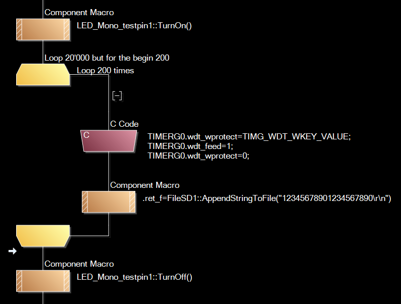

Here is my test
I reduce the number of test to 200....
It's need 1 second
sd_card_Test2.fcfx
(30.33 KiB) Downloaded 1519 times
