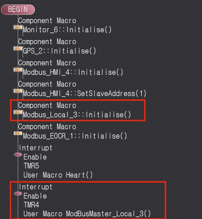

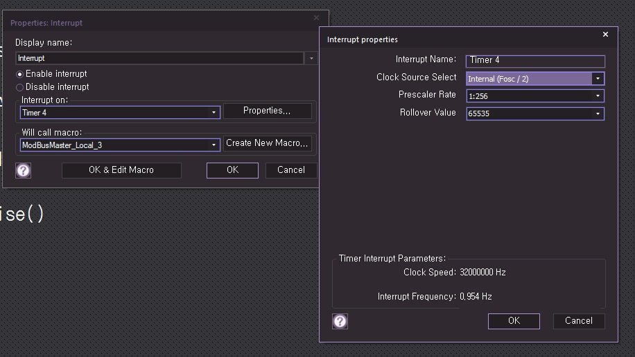

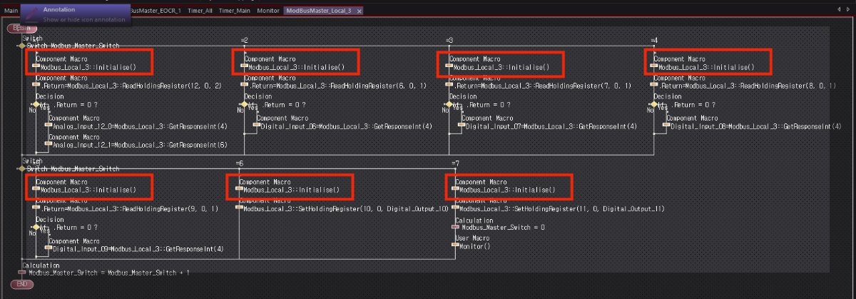

I think I'm halfway through this. The reason is somewhat strange, but it works faster and more accurately than before.
This was solved by repeating the initialization operation.
I describe my program here for reference for others.
I set up the Modbus master as shown in the picture.
Then, the component module was initialized, and a timer interrupt was used to generate an interrupt of about 1 second and call the Modbus master subroutine.
If the call time is too fast, the system seems to freeze.
And it seems to work only if it is initialized in the called routine. If I do not initialize it, sometimes it seems to operate normally,
but previous data is loaded.

It's tricky for me to comment as there's a lot going on in your program. There are two modbus masters, a modbus slave, GPS and a UART all taking part of the runtime.
What might be handy is to try and find out what is taking up the majority of the runtime. So you start a high speed timer running and increment a counter. You look at the counter when uyou start a macro and then again when you end a macro and this will tell you how many interrupt ticks you spent in that function. With some trial and error you should be able to trace what is taking up the majority of the time.
In the ModBusMaster_Local_3 macro you have seperate read functions for holding registers 8, 9, 10, 11 and 14. Then two seperate write functions for 12 and 13. The reads and writes could all be done in single functions to speed things up significantly. I've attached an updated version of your file with this function improved.
230901_Freezer-MCU-Serial.fcfx
(52.9 KiB) Downloaded 751 times
The macro ModbusSlave_HMI_4 could undergo a similar optimisation to cut down the number of transactions required from 8 to 2.
