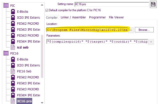

with this, I will able to use XC16 pro compiler from microchip ?
it's strange because according to your previous post, the .bat folder file should be in the new install location !
This might work for the new XC16 compiler:
Install the new compiler in a separate location
Copy the "batchfiles" folder from the old installation to the same place as the new one
-- the "batchfiles" folder should be at the same 'level' as the "bin", "etc", "include", etc.
Point Flowcode to the new installer location within Global Options...Locations
-- this location will be the folder containing the copied "batchfiles" folder
Restart Flowcode
how location should be there ?
with this location , compilation failed
how to be sure that XC16 compiler from microchip will be used or is used?
thx

My previous instructions were wrong. Sorry about that. They should be:
  • Install the new compiler in a separate location
  • Point Flowcode to the new installer location within Global Options...Locations
    -- this location will be something like "C:\ProgramFiles\Microchip\xc16\v2.10"
  • Restart Flowcode
The batch files in the actual toolchain location are no longer used. The ones used are within %PROGRAMDATA% and need to be replaced with the ones I attached earlier.
Also note that changing the toolchain in this way may not fully work. I'm providing these instructions to help you (and others) set up and use the latest compiler. I have not fully tested this new compiler and using it instead of the one we provide may have compilation and execution issues.

done, how to be sure that Xc16 compiler from microchip is used during compilation ?
Re: PIC16 toolchain for FC9
Posted: Tue Sep 12, 2023 5:02 pm
by Steve-Matrix
When you click to build, you should get something like the following:
Launching the compiler...
C:\ProgramData\MatrixTSL\FlowcodeV10\FCD\PIC16\batchfiles\pic16_C30_comp.bat "E:\ProgramFiles\Microchip\xc16\v2.10\" "xc16_test" "E:\DEV\Flowcode\programs\" "24F08KA101"
The first parameter should be the new toolchain location (for me it is E:\ProgramFiles\Microchip\xc16\v2.10, but yours will be different).
Posted: Tue Sep 12, 2023 5:05 pm
by Xbiotec
it work's , :D
C:\ProgramData\MatrixTSL\FlowcodeV9\FCD\PIC16\batchfiles\pic16_C30_comp.bat  "C:\Program Files (x86)\Flowcode\Compilers\xc16\v2.10\" "PIC24FJ256GA705test2" "C:\Users\seb\Documents\AAA Microchip\" "24FJ256GA705"
thx a lot
