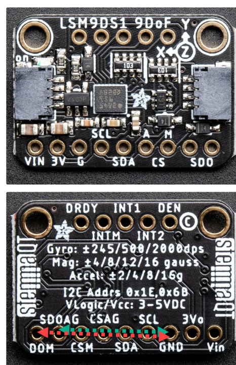

There is a nice Breakoutboard wit a LSM9DS1 and two qwii connector.
Adafruit LSM9DS1 Accelerometer + Gyro + ... F Breakout
It's working with FC10 on an ESP32 simple and stable.
Another big advantage is that two sensors can be connected with one cable and the address of the second sensor can be changed with two small solder bridges. FC10 supports both addresses very comfortable. Also a long Qwii cable can go to the first board and from there a short Qwii cable to the second board. Each board has two Qwii connectors.

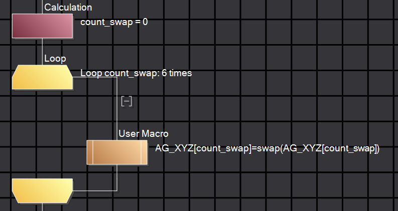

The 16 bit values from the Accelerometer/Gyro are in the wrong order, high byte and low byte are swapped. So I have to swap them myself back.

Swap the A/G byte order:

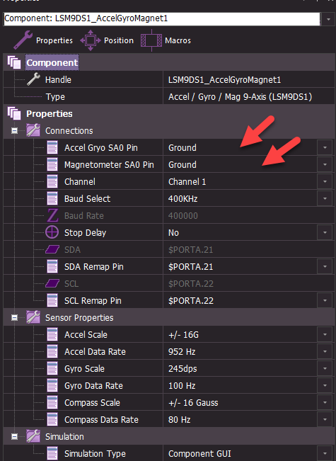

choose Ground if you use the bridge to ground:
Just solder a bridge:

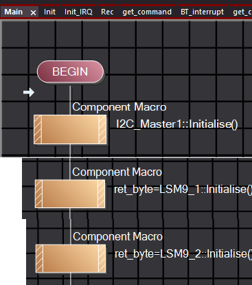

I tried to evaluate the return value from initialize the component
but no matter if the LSM9DS is connected or not, the return value is always 0.

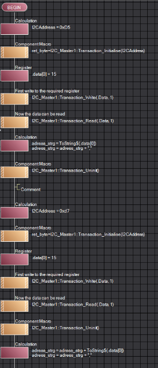

So I tried to read a register from the LSM9DS.
Register 15 should always return the value 61 at the AG or 104 M.
But both times it reads the register from the first LSM9DS used. There is something small wrong
How I did it when the ret_byte were always 0:

I tried to make a macro to read the register values. I want to use it to read the values and change them later, for example to switch filters on or off.
But I have a little problem with the I2C master. Do I have to initialize the transaction and then deinitialize it again?
And is the I2C master the right component for this?
Init all:
use the macro:

2.The 16 bit values from the Accelerometer/Gyro are in the wrong order, high byte and low byte are swapped. So I have to swap them myself back.
3. I tried to evaluate the return value from initialize the component but no matter if the LSM9DS is connected or not, the return value is always 0.
4. Update the component so register read/write works.
So you will probably need to switch the bytes back in your program or simple disable the icons that do the switching.
