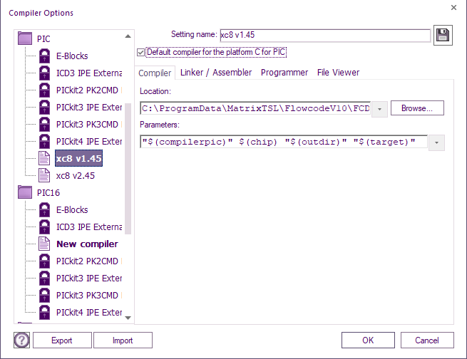

Re: W5500 Ethernet not working in Version 10
Posted: Mon Sep 25, 2023 8:39 pm
by medelec35
OK, Let's get you up and running with getting the v98 compiler to wok with v10.
I'm assuming you placed the extracted file called pic_xc8_v1.45_comp.bat
Within: C:\ProgramData\MatrixTSL\FlowcodeV10\FCD\PIC\batch\
If that is the case, when you select Build > Project options, can you take a screenshot of all of the compiler window with the Compiler tab selected and the PIC on the left showing
For example here is mine:
- Compiler options FC8 compiler1.png (38.35 KiB) Viewed 11515 times
Within the location window should be:
C:\ProgramData\MatrixTSL\FlowcodeV10\FCD\PIC\batch\pic_xc8_v1.45_comp.bat
Unless you renamed your bat file to something different?
