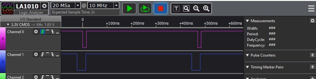

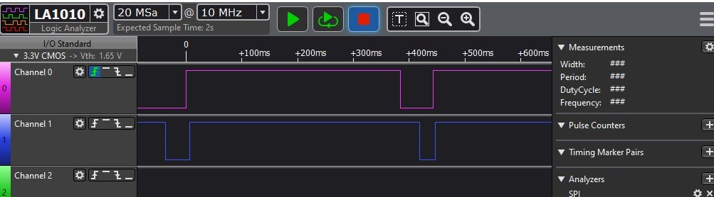

I connected a decoder to a logic analyser and this one seems to have little bounce if rotated smoothly (but it does suffer if not)
Clockwise two clicks
Anticlockwise two clicks
I downloaded the example Quad_Encoder_Timer file from the WiKi, changed the chip / ports to suit, and set the component postcaler from 1:1 to 1:4. As each "click" creates four transitions having the scaler set to 1:4 returns "click count". Note I'm using a KY040, other modules may differ)
