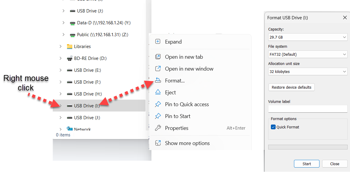

Using Partion Master by Ease US (free edition) I reformatted both the 2Gb and 32Gb card and these both worked in the reader. I stress I've only created a file called "test.txt" on the card. Nothing else.

Might be the way Windows formats cards as yesterday I couldn't get the 32Gb to do anything and afterwards was unreadable, with the 2Gb becoming unusable with Windows unable to bring them to life. Ease US could access.
Formatted with Ease US I've had no issue so far.

I just use the windows for formating the sd cards.
One problem I remember when I had the SD card on the same SPI bus as a display,
I had to adjust all the clocks to the card init clock. That was the only way the card worked
Format with windows...

All my issues seem to have disappeared now that I formatted using 3rd-party tools. I can't explain why but although formatted with W10 before insertion they either could not read/write at all or quickly became unreadable and unformatable using W10. This would suggest some form of corruption took place.
Maybe using command line I could have resolved, but Ease US was just a couple of clicks <s>
