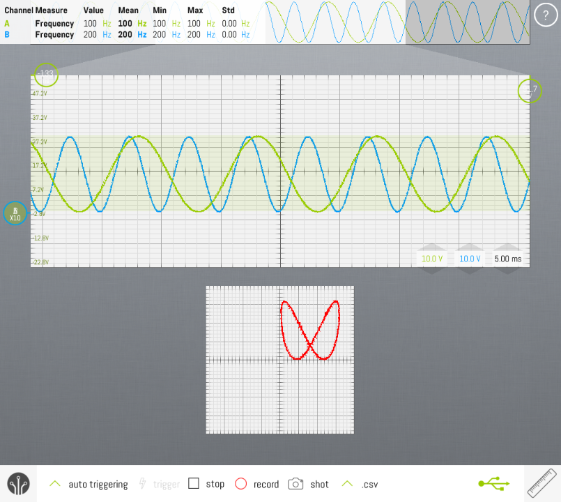

Started work on a Lissajous figure 'generator'.
It is possible (and probably easier) to generate the figures algorithmically - but I feel this needs to be 'analogue' (well almost).
Initially I tried using the DSP components wave generator (using v5 of the esp-idf tools - the timer interrupt fails - so downgraded to v4) - but rewrote using the DAC components for the ESP32 (output on A25 and for DAC2 A26) - and we could probably use the binaural beats generator too?
Still need to add 'varying' the frequency using a switch to alter - but here generating sine waves at 100 and 200Hz - we get our 'first' Lissajous figure :-)
I'm using a 100 value lookup for the sine curve - alter hold1 or hold2 to alter the frequency... Might be useful to allow amplitude variation too?

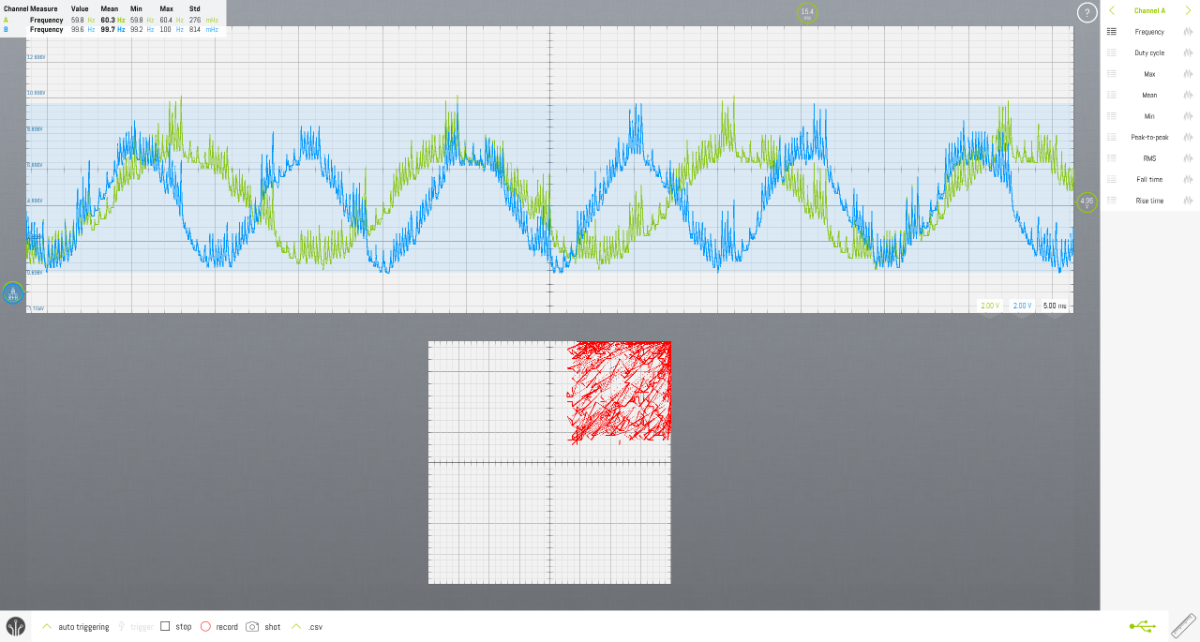

Just tested with the binaural beats ' machine'. The wave forms had become very 'noisy' and not nice :-(
Removing the i2c OLED display fixed this - must be electrically noisy - possibly needs a smoothing cap?
With the display removed things resumed their harmonious state...
With OLED display (displaying stuff made it worse)

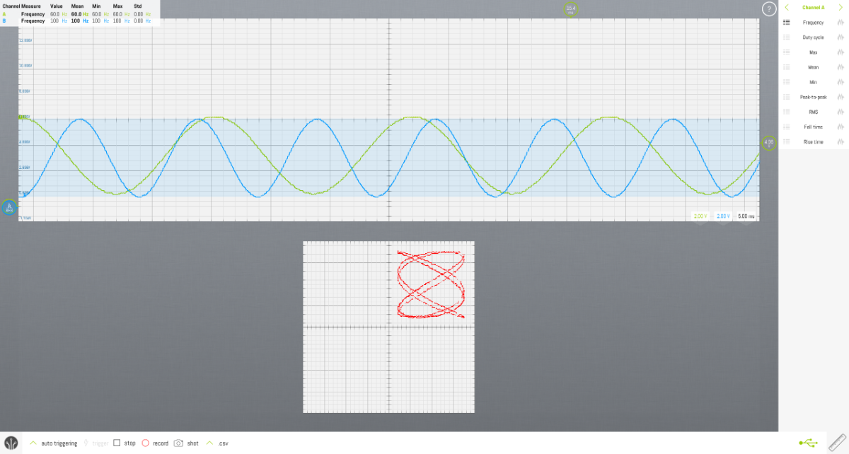

And with the display removed:

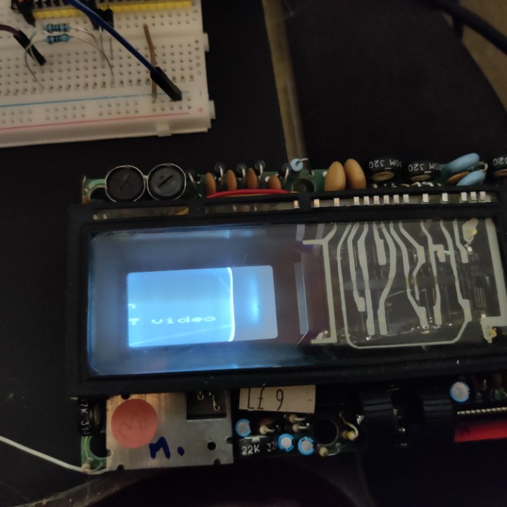

Finally got a picture onscreen. Using a tiny 200mw UHF transmitter - I fiddled rather too much trying to get the esp32_composite_video_library to compile (it looks excellent - and I managed to add it as a component to a FC sketch - but some compilation errors remained :-( ).
Then some fiddling trying to get some accurately timed pulses on esp32 with minor diversions into DAC_Continuous and gptimer (and v5.1 of the espressif tools). Everything seems to have changed and be deprecated in esp32 land- timer (now gptimer) RMT (tried that too) etc.
In the end - I gave up loaded a sketch in the Arduino ide and after a little fiddling there was an image :D I'd added a voltage divider to an esp32 and it didn't need it (composite video - 0.3v for black and 1v for white) see http://www.batsocks.co.uk/products/Other/TellyMate.htm - and I still think that B/W composite should be doable (the TellyMate uses an AVR 328p!
The picture is 'shifted' left and 'twiddling' the various adjustment pots would not get it further across the screen - and I'm not brave enough to go in with the soldering iron....
And then - an animated gif!
(It's a cat riding on the back of a giant space squid - or the right hand half thereof)

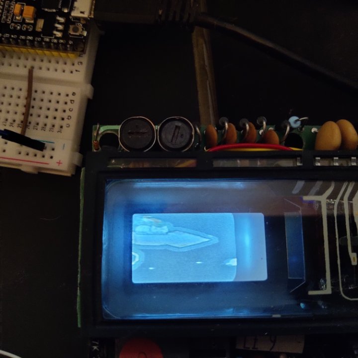

Remarkably the esp32 is outputting composite video in colour. Changing the setting to PAL (it was in NTSC) - improved things.
On the Sinclair and a pocket Casio - picture was 'ok' - B/W much clearer than colour. On a cheap '6in' Nikkai set - the picture (and colour) was better - but rolled vertically slowly (so timing slightly off)
