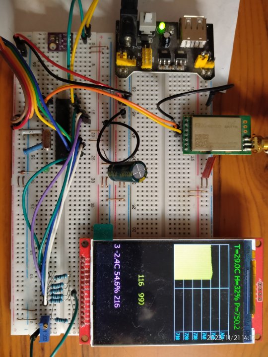

I will need to replicate your setup exactly.
How did you interface it with the Arduino e.g. connected MOSI, DC pins etc. directly to the pins of the ATMEGA328P, or did you use resistors (if so one or two per pin and what value/s), level shifter etc.
Can you go into detail about the wiring of the display to the Uno.
Have you modified the module e.g. shorted J1?

I haven't modified J1. The display works via a software SPI
