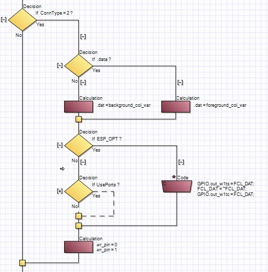

Aha I see you're not using the parrallel component and instead rolling your own code. Well then I send out the 16-bit data like this.
GPIO.out_w1ts = FCL_DAT;    //Write all the 1's
FCL_DAT = ~FCL_DAT;
GPIO.out_w1tc = FCL_DAT;       //Write all the 0's
FCL_DAT is my local 16-bit colour variable I'm sending out.
It might be worth you trying the component and see if that's any better for you.

It looks like maybe the Flowcode port write code could do with a bit of improvement as currently it does it the recommended (and very slow) way of bit by bit. I'll see if I can use the method I've used in the component for the port writes.

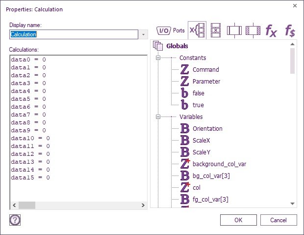

Aha I know what the all blues are about I've had that too. In your initialise you might just need to ensure you have written to the higher byte using a output icon or similar. Otherwise the higher 8-bits are not defined as outputs.
e.g. your LCD_Write_Data8_Bus defines the lower 8-bits as outputs but not the upper 8 bits.
This is how I do it in the component at the top of the initialise function.
I can then do the 8-bit command writes in the same high speed optimised way.
Re: Speeding up the ILI9488 SPI display (esp32)
Posted: Mon Jan 15, 2024 3:42 pm
by mnfisher
Thanks - yes that fixed it.
I tried : port_high = 0 which didn't work(?), but output of a8..a15 of 0 and suddenly the world is suddenly a more colourful place!

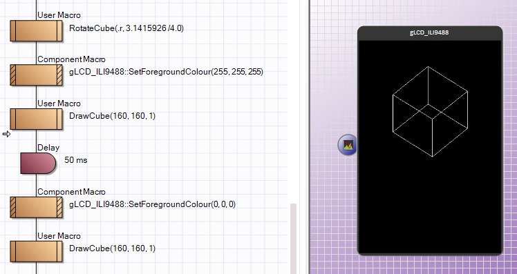

Just tried a 'cube demo' and with the old component - this compiles and draws the cube (albeit (very) slowly).

cube_test.fcfx
(23.26 KiB) Downloaded 1079 times

cube_test.fcfx
(23.25 KiB) Downloaded 1065 times
As for making the cube spin faster could you instead draw the cube in white, frame delay, draw the cube in black, rotate the cube, repeat. Should be significantly faster then clearing the display each time. I imagine you already know this.
