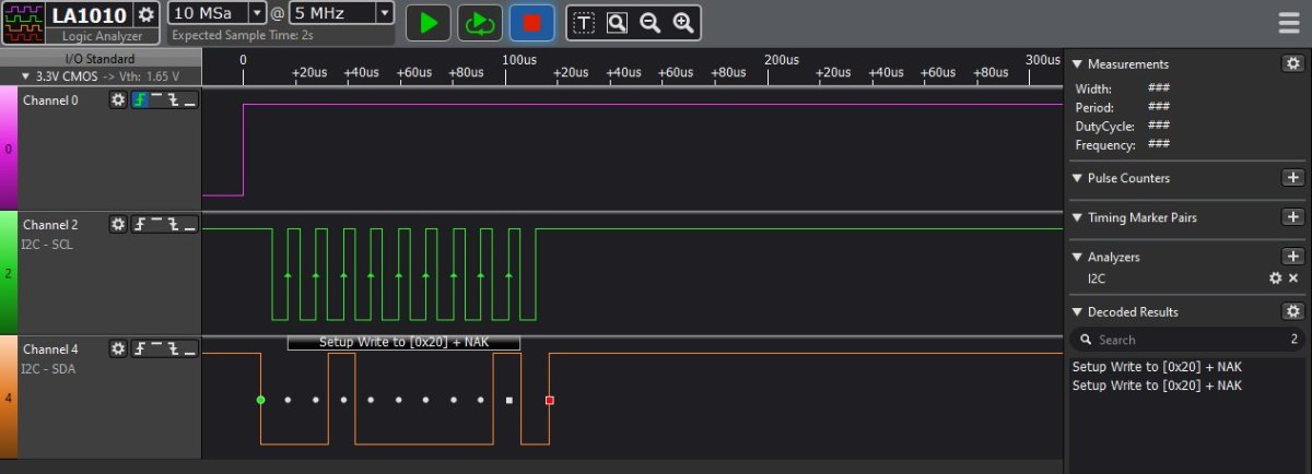

by chipfryer27
Hi Leigh
Using Transaction on Ch1
Transaction on Ch1.jpg (65.38 KiB) Viewed 4320 times
In a previous post (that I probably linked to) it did mention transactions :oops:
