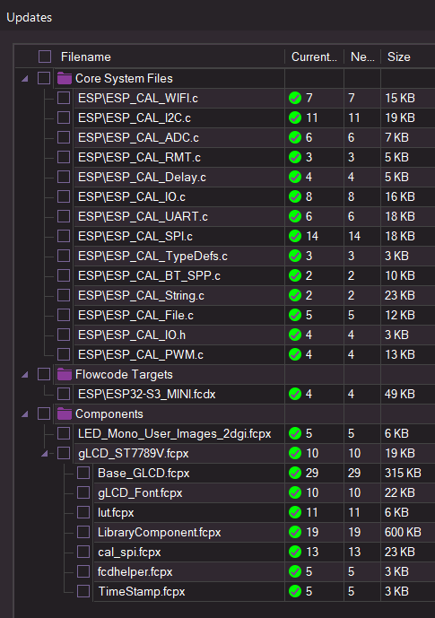

Here a list of my component.
They should all be up to date

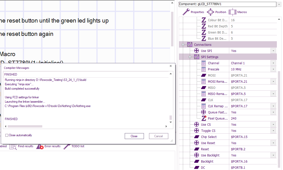

Hi Stefan.
To be on the safe side have you done a Full database component update?
I did the compiling in SPI mode.
successful SPI.png (84.7 KiB) Viewed 8866 times

Hi Martin
Yes, I do a full database update every time. I only have the components that appear in the project published. Maybe you can take a screen shot of your components, then we can compare we have the same version.
