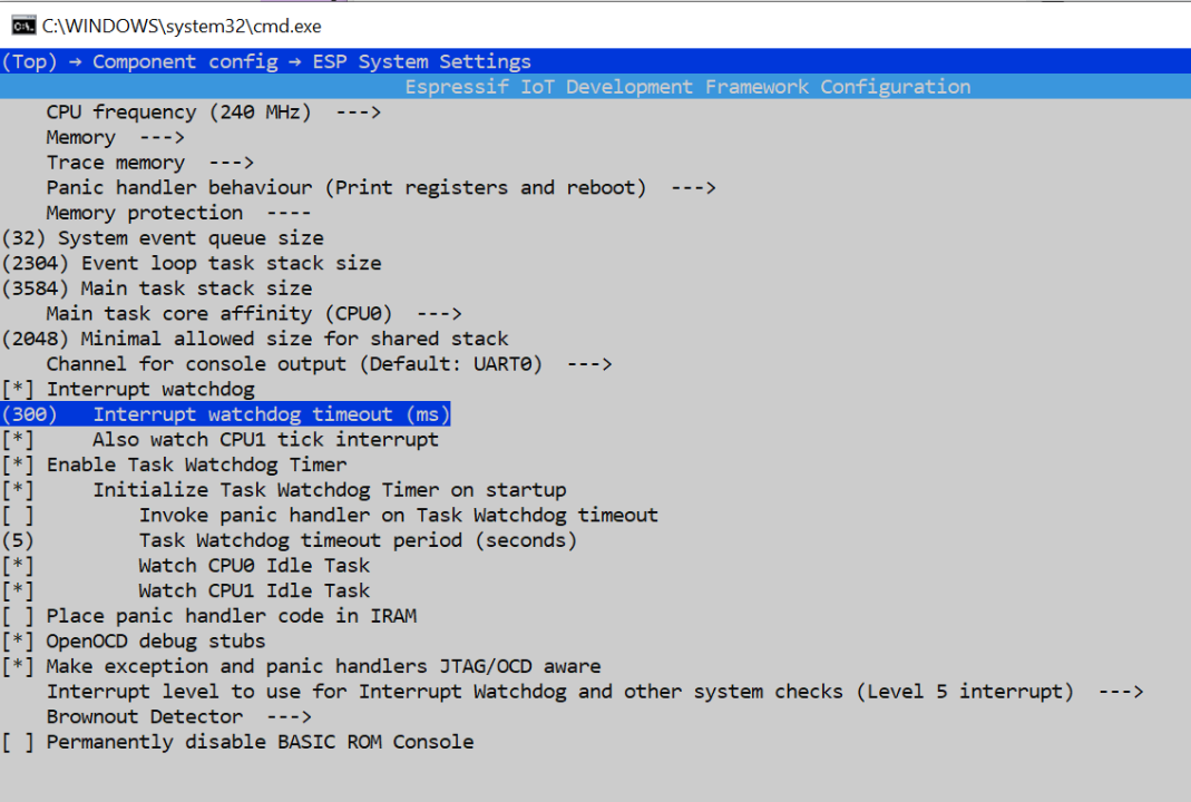

How Can I use this a c-code?
or turn off or set different value in Menueconfig?

I managed to switch off the watchdog. I did a test, sampling the data in the main and sending it in a second task. That worked . But if I use the fileappendstring instead of send with uart, the program crahed and I have to press reset.
