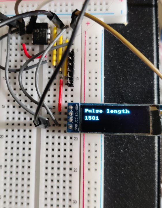

I modified to run with a PIC12F1840. Running at 32MHz and capturing every 16th rising edge it can measure 320kHz (or more) (giving a count of 380 at 320kHz)
Here measuring an 80kHz signal - which the scope shows as have 12.5us between rising edges - so 16 count is 200us. (1/80000 * 16 - so the maths corresponds :-) )
At 32MHz (8MHz instruction rate / FOSC as each instruction takes 4 clocks) - we have TMR1 ticks taking 1 / 8000000)
This calculates to give a count of 1600 (0.0002 / (1 / 8000000)) - so allowing for clock errors etc - I'd say the result is pretty good....
Note the code is almost identical - need to select the input pin (can be RA2 or RA5 - I use RA5 to allow use of i2c - however hardware mode doesn't work (a bug?)) - the 'connector' to the right is for PicKit connection. The scope is also attached to ground (on the display) and RA5), signal generator attached to RA5 and VSS pin
For measuring lower pulse rates we need either to set a lower clock for the MCU, or a prescaler for TMR1 (or both)
It would also be possible to count the interrupts and 'average' the pulse length (as it stands it measures the time of the last 16 rising edges before the peripheral interrupt is disabled) As is it can measure down to ~2kHz (a count of 64068)
Re: PWM + Сapture + Сomparison
Posted: Thu Dec 19, 2024 3:20 pm
by carworker
Hi Martin! It looks like I managed to measure the pulse length. But I'm not sure if I did it right. Please take a look.
