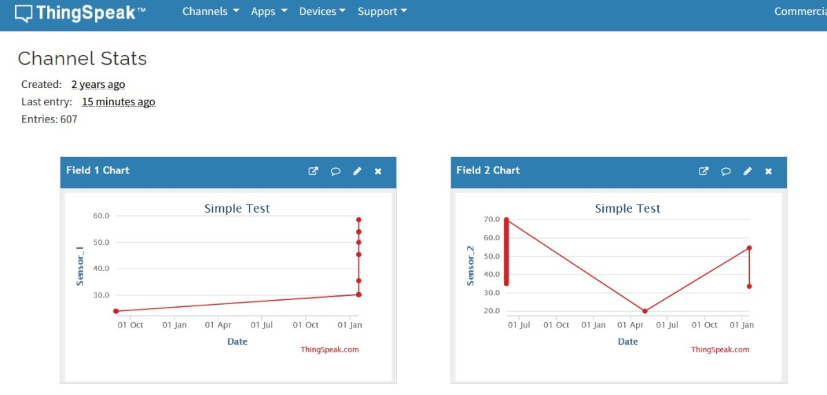

Actually, to emphasise how easy FC makes this I have modified the WiKi example to update my ThingSpeak. You will need to modify to suit your TS account/channels/fields. In the mqtt component enter your unique details where I have "Your ID" etc. In the component macros enter your unique details (where I have "01234").
This simulates if you enter the correct channel in Network Comms Components for your LAN/WiFi interface. If you don't see an ip address select another channel.
Screenshot 2025-01-19 144009.jpg (57.44 KiB) Viewed 7454 times
