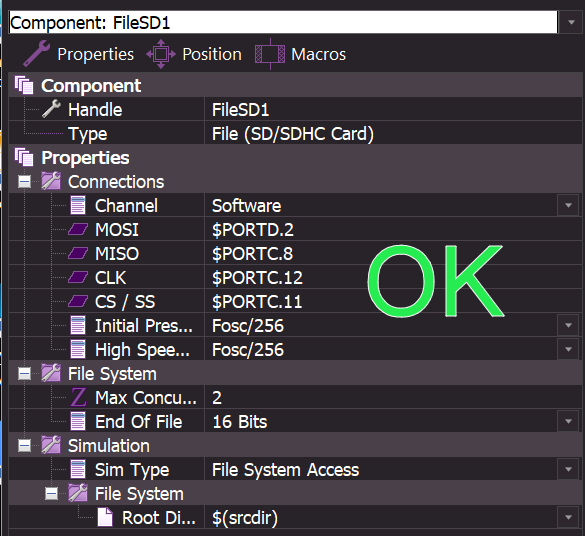

Hi LeighM, Hi Marti

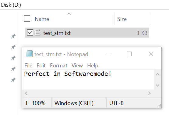

Yes it's working in software mode. With the SPI unfortunately not yet.
The software mode is usually too slow. I will try it out.
It would be an advantage if it works with the SPI Hardware.
I will also try it with the hardware from the post, which I will also use
viewtopic.php?t=3053
Setup working in softwaremide
