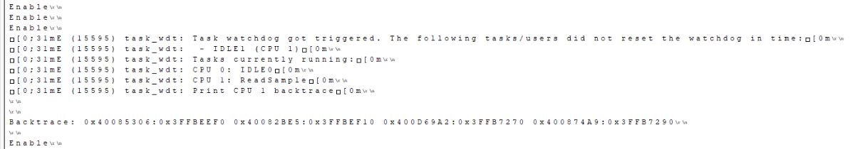

'semaphore' or 'signal' or 'Flag' i have already tried, it works, but the watchdog is causing problems.
sometimes I don't need a delay sometimes I need 10mSec delay.
is there any other way than using a delay'? for example a watchdog reset?

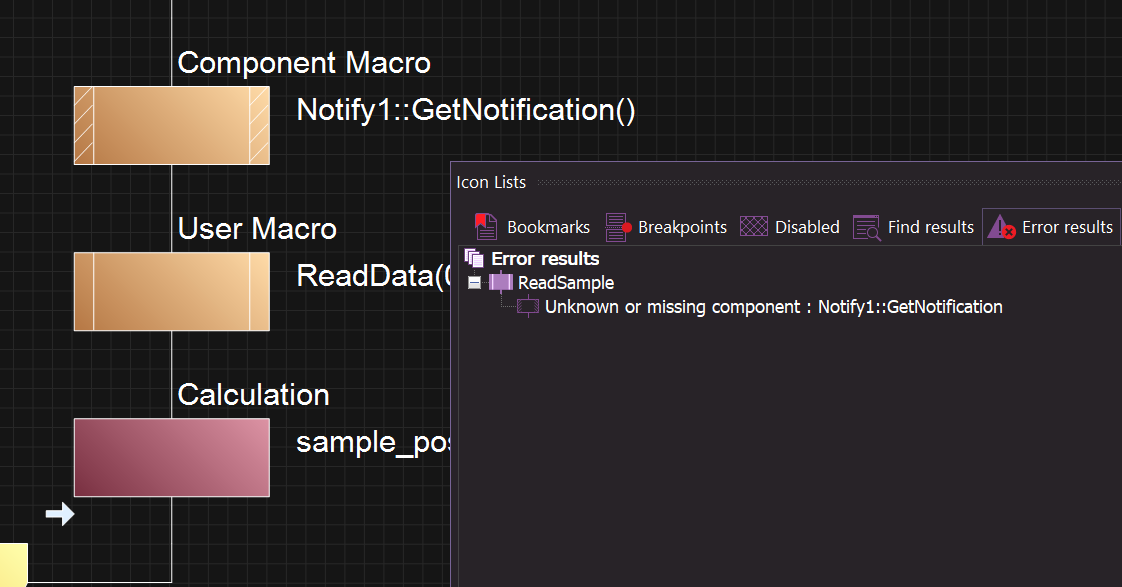

I just suspect I need a component Notify ?
Component:
Re: ESP32 read i2c or i3c in IRQ macro
Posted: Wed Apr 23, 2025 7:41 am
by stefan.erni
I found the component and I copie the component
I working now
%ProgramData%\MatrixTSL\FlowcodeV10\Components

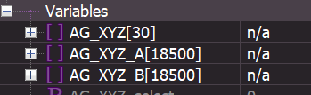

Some thoughts on double buffering....
Assuming a buffer size of 1000 records - increase the receive buffer to 2000 records (note this might be adjusted to suit the 'save' task - maybe 1 SD card sector size?)
Then the read sends a notification to Save when pos == 1000 (save buffer_ 0 - buffer[0..999]) and pos == 0 (save buffer 1 [1000..1999) - the notification can wake the save task and also pass the buffer number to save?
Alternatively - using two buffers - requires a conditional in the read - but again notify the save task on 'full'...
Buffer Size for 1000 records 2x ACC xyz Gyro xyz in =12000

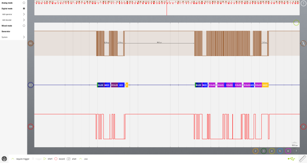

That's good 😃 Have the 'whiskers' disappeared from the trace?

Yes the 'whiskers' disappeared from the trace

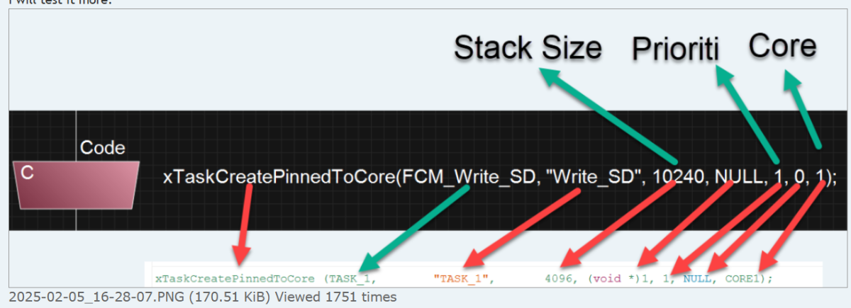

I have used the pinned task to write data to the disk. The 10ms I need for the watchdog reset is no problem.
But I can't use it to sample data. I tried using the Notify component but that doesn't work either with my task.
With you task it's perfect!
I have not yet understood the Notify component exactly.
I have changed your program to test the IRQ and the uart shows text or ad error message.

error from the wdt send to uart automatically
Pinned to task:
