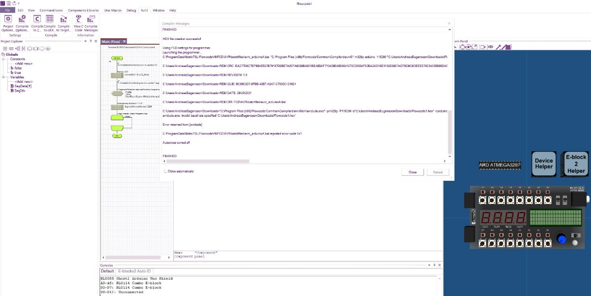

I have the same problem, do you know how I can fix it?
Flowcode error.JPG (91.84 KiB) Viewed 5852 times

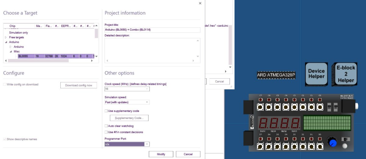

There is no way to change the baud rate in Project Options.
Flowcode Project Options.JPG (70.27 KiB) Viewed 5852 times

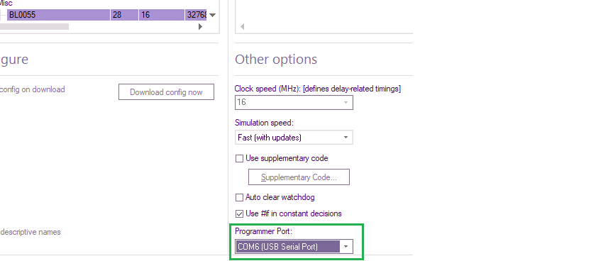

You need to select the correct com port for the BL0055:
Correct port.png (21.74 KiB) Viewed 5851 times

It's vital that the programmer port does not show n\a.
