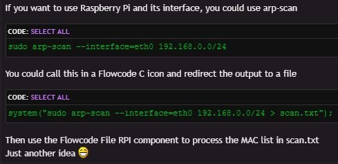

If you want to use Raspberry Pi and its interface, you could use arp-scan
sudo arp-scan --interface=eth0 192.168.0.0/24
You could call this in a Flowcode C icon and redirect the output to a file
system("sudo arp-scan --interface=eth0 192.168.0.0/24 > scan.txt");
Then use the Flowcode File RPI component to process the MAC list in scan.txt
Just another idea :D
